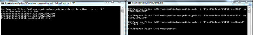

I could see that the setup is working correctly when the outputs started appearing in the subscriber window. Here are the screen shots for both Subscriber and publisher.
Mac OSX
Windows

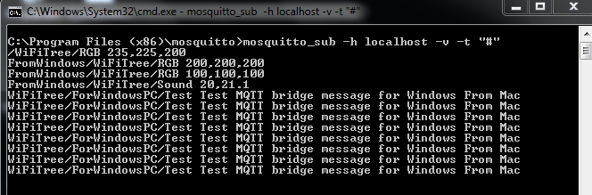

After the configuration change I restarted my mosquito demon and sent out some test messages from my mac:
mosquitto_pub -t WiFiTree/ForWindowsPC/Test -m "Test MQTT bridge message for Windows From Mac"
Success!!!. i was able to see that my Windows PC was receiving only those topics from mac.
