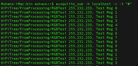

Testing the MQTT Library setup
I created a new sketch and ran this code. I could see my MQTT messages from processing are retrieved by the mosquitto_sub client.

Results from mosquitto_sub
