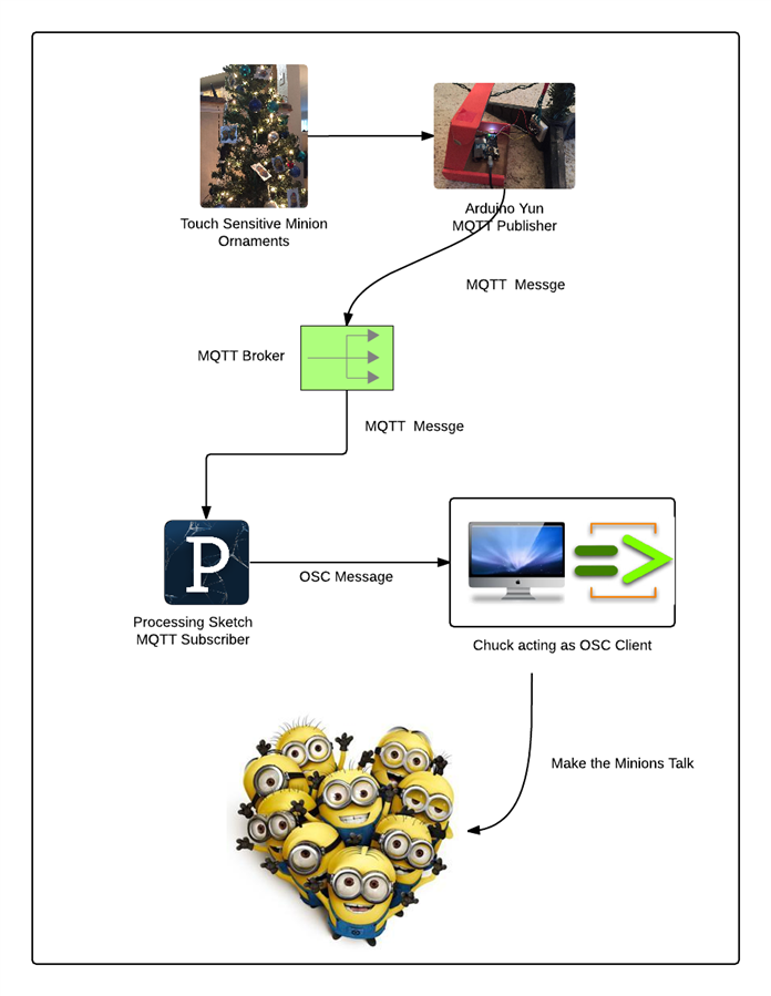

Here is a high level diagram of how it all works.

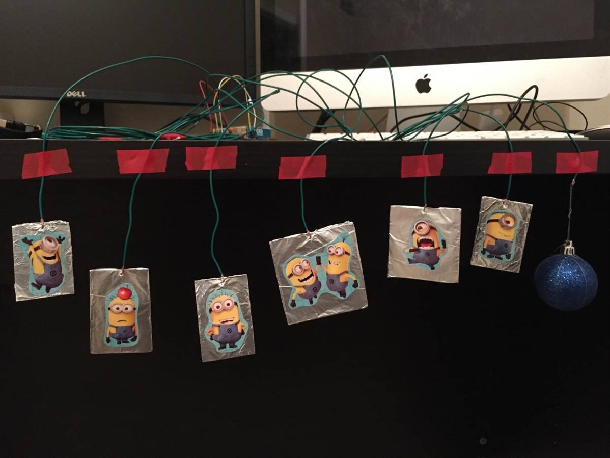

1. Home made Minion ornaments ready to be tested. I couldn't find the minion ornaments in the local stores. So I just used aluminum foil from the kitchen to wrap around piece of cardboard. And stuck the minion stickers on them.
Notice the last christmas ornament. This is wrapped around with conductive thread. This is what i originally intended to do if i get the actual minion ornaments. This works well too.

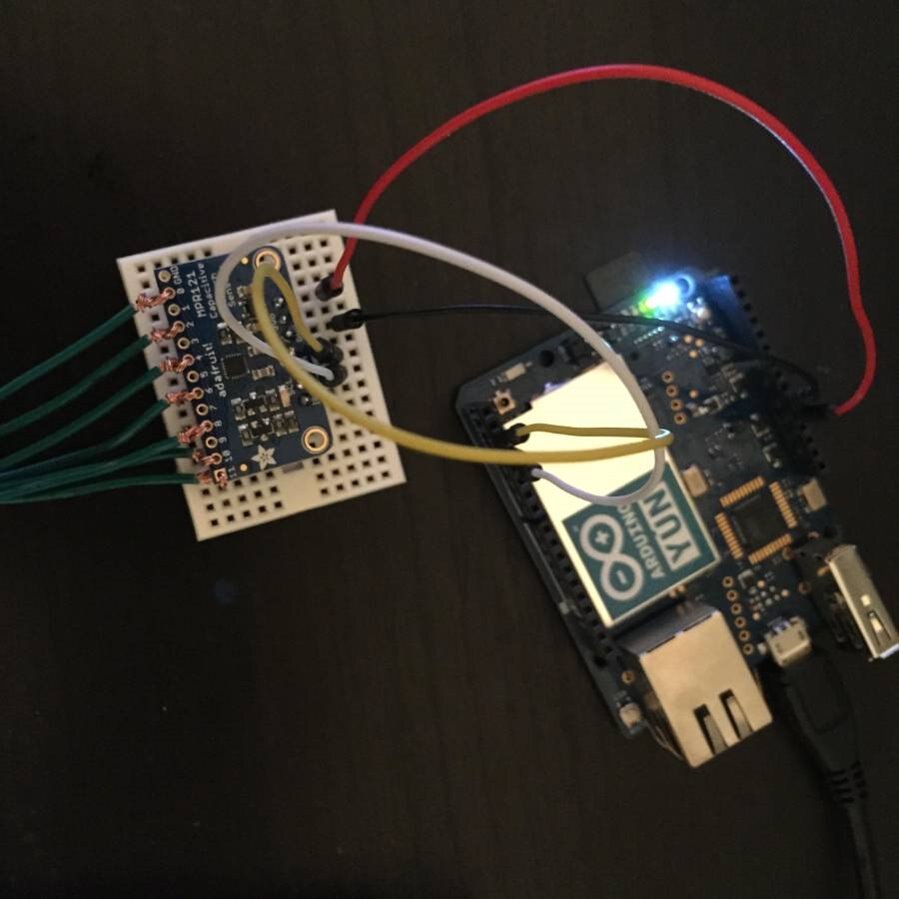

2. Wiring:
Arduino Yun is connected to the Adafruit MPR121 touch sensor break out. Since this is a temporary arrangement i didn't solder the fires to the break out. The break out speaks I2C. On Yun the SDA and SCL are on the digital pins 2 and 3.

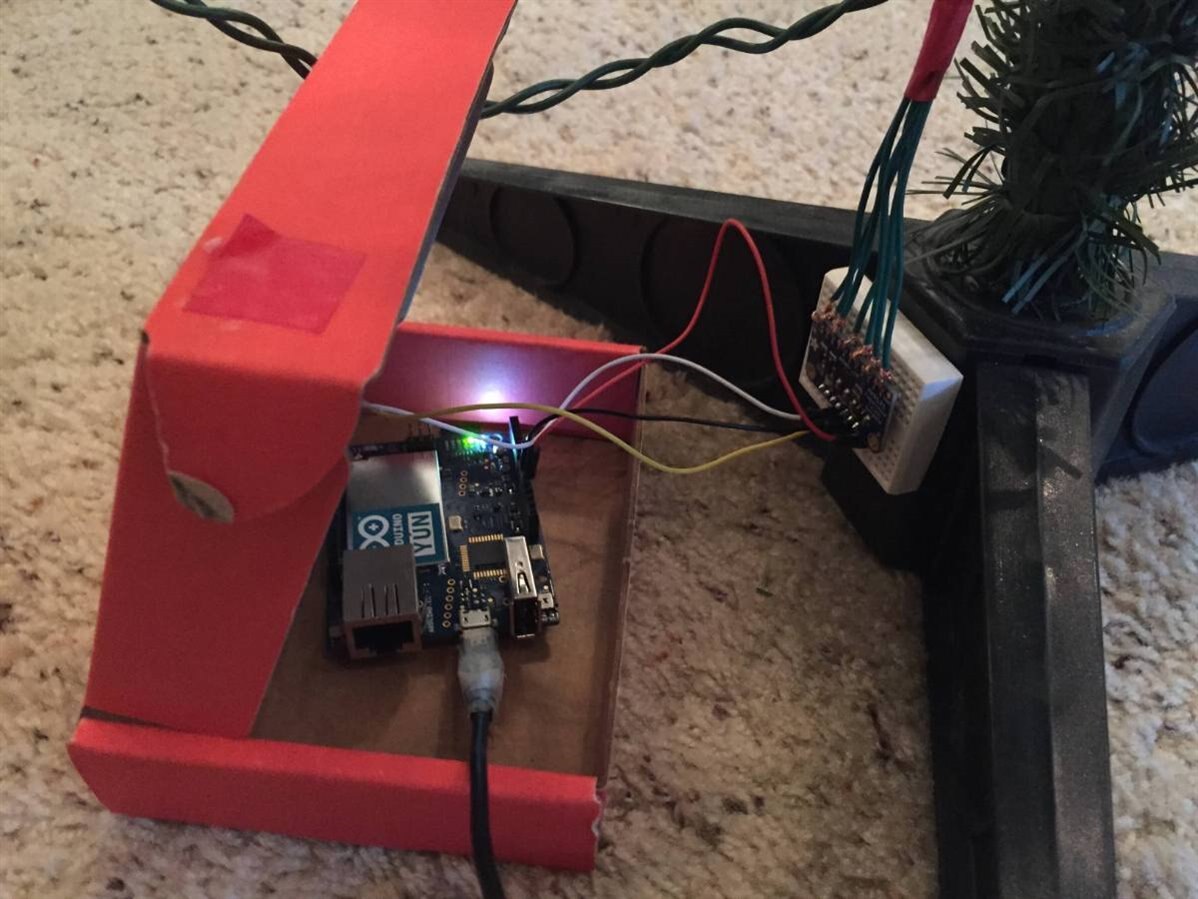

3. Yun connected to tree. (Officially becoming a WiFi Tree)
The small breadboard had a 3m sticker on the back. So i was able to peel it off and attach it to the base of the tree. So this tree is going to be a bread boarded tree forever. In the years to come i hope this bread board gets used for other projects. I just kept the Yun in one of the shipment boxes for now. Later when other parts of the WiFi christmas tree project is done i will plan for an enclosure.

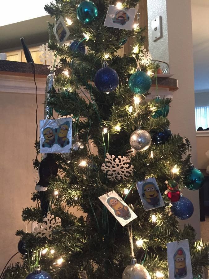

4. Minion Ornaments on the Tree
I was really happy once it all worked on as planned and the look on my 5 year old son's face was priceless when he touched one of the minions for the first time and it went "whaaaaaaaaaaaaat" image
