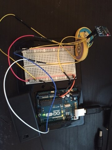

In this post i will cover how i used Arduino Uno with an ESP8266 to publish a MQTT message with RGB values.
Arduino Uno + ESP8266
I ordered the ESP8266 during this road test because my initial plans of using an Arduino Uno with a CC3200 Simple Link Launchpad didn't work out very well. For $7 it provides bang for the buck as long as you tolerate the initial getting to know you phase. Most of the frustration is because of the different versions and the lack of official documentation. That though seem to be improving of late as the firmware seem to have stabilized somewhat and an updated SDKs seem to have been released this month.
I was lucky in that the ESP8266 i got already had the latest firmware and i had the version v0.91 board.  I didn't have to update the firmware. The following is the pin definition of my ESP8266:
I tried initially to try to use the UNO as a FTDI driver by connecting the ESP8266 to Uno with level shifters. But that didn't work. No response at all from the ESP8266. Then i bought a FTDI breakout board with a 3.3v output and i was able to talk to ESP8266 using CoolTerm (Except for the Arduino, i am using all these different tools for the first time. That added to frustration levels sometimes. But it was well worth it as it helped me learn so many new things). Once i become comfortable with the AT commands, i hooked the ESP8266 back to Arduino Uno using level shifters.
Again nothing from Uno.
One of the major misconceptions out there seem to be around using level shifters. Every one (including much respected AdaFruit) keeps saying you need to use level shifter to connect the RX pin of the ESP8266 to Uno's TX pin since uno operates at 5V. But the data sheet i found here says this in page 15.
All digital IO pins are protected from over-voltage with a snap-back circuit connected between the pad and ground. The snap back voltage is typically about 6V, and the holding voltage is 5.8V. This provides protection from over-voltages and ESD. The output devices are also protected from reversed voltages with diodes.
I am not an electrical or electronics engineer. But that statement seemed to me that it might be OK to connect the ESP8266 directly to my Uno. So i just did that and it worked. (It would be interesting to hear from the engineers in this Element 14 community about that particular statement above)
Following is the wiring i did:
1. Arduino 3.3v power to bread board red power rail
2. Arduino Ground to bread board ground (black rail)
3. ESP8266 Ground to bread board ground (black rail)
4. ESP8266 CH_PD to bread board red power rail ( This is the reset pin. I was not brave enough to connect it to Uno's reset pin. So every time i loaded my sketch, i had to pull this out and push it back in. A veritable stress test i would say.)
5. ESP8266 TX to Arduino Uno Digital Pin# 2 ( i will be using software serial library to designate this pin as RX for arduino)
6. ESP8266 RX to Arduino Uno Digital Pin#3 ( designated as TX pin using software serial library)
7. ESP8266 Vcc to bread board power rail
That's all. I have been using this setup for a few days now. It has gone through couple of power surges (too much bad weather with lightning here) and still working.
