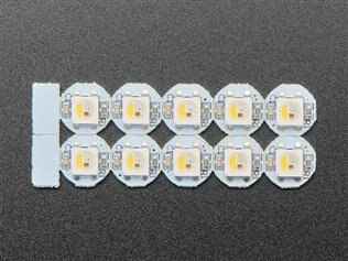

Part of my project with the Arduino Portenta requires some lighting and I wanted to be able to individually control them. I asked a model railroad mate and he suggested NeoPixels. They only require 3 wires, run on 5v and can be controlled from a range of microcontrollers. The standard ones do RGB values but there is also a variant with an additional white LED. I found some on a small breakout that did RGBW and could be bought in packs of 10.

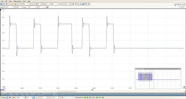

There are a number of libraries for Neopixels including an AdaFruit one, FastLED and FabLED. These all have fine-tuned code to make the pixels work well on AVR platforms.  However, after looking at the AdaFruit one it had some examples for STM architecture (same as the Portenta) and also examples where the "show" function was separated out into a separate file. This helped me work out how to integrate Portenta so I forked that library - https://github.com/Workshopshed/Adafruit_NeoPixel and did some experiments with a simple digitalwrite. For the timing I dug into the mbed library and found a wait_ns function. That was configured with the delays as per the examples in the other variants. That didn't give me a working result so I dug into Josh Levine's post NeoPixels Revealed and found the timings out. When I looked at my timings with a scope, there was a much large delay than I was specifying. I suspected that digitalwrite was the culprit and swapped that for a lower level call I found via an_dreh in their Fast GPIO toggle example on the Arduino forum. I suspect even lower level options are available but this combined with some adjustments to my timings meant that the NeoPixels were displaying.
I created a simple loop to test the brightness of the white LEDs and found that I was getting a green LED lighting up on the first pixel. I had initially thought this was because the first pixed was getting the signal at 3.3v and added a simple level shifter to the circuit. However this did not make the problem go away.
So I made some tweeks to the library to ensure the IO pin was initially low and that there was a gap before the first data byte. And that fixed the first pixel being green. Finally, I knew that brightness of LEDs was not a linear function so borrowed some code from Diarmuid Mac Namara and made the LED brightness non-linear depending on an exponential function.
