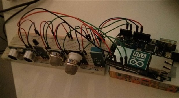

Hello everyone!
Here I am with the second step of my project. In previous point (http://www.element14.com/community/groups/arduino/blog/2014/12/23/the-smart-entrance--my-project-for-internet-of-holiday-lights-roadtest) I explained how to install mosquitto.
I go then to explain through a couple of pictures and code what I did to make it possible to write in the topic I chose updates of the data collected by the sensors.
Every 10 seconds my Arduino Yun reads data detected (humidity, temperature, air quality, fuel gases, flames and distance) from the sensors connected (see photo) and, through the MQTT protocol communicates them to the server.

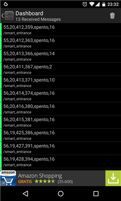

To verify that everything happens correctly I installed in my smartphone "MyMQTT", a simple but powerful application to enroll in the topic, and also wanting to write messages on them. The configuration has only required the inclusion of IP of my server and the topic to which register.
Once started Arduino, as you can see from the screenshot, every 10 seconds, the topic is updated with the sensor data.
Below I leave you also also the code I used to be able to carry out the above and in the attached library for MQTT. Unfortunately this is not Paho as it is very greedy for space and occupied memory (about 92% against a 46% of this).
