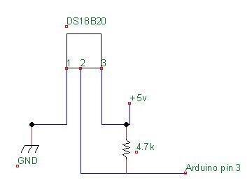

Hi,
I'm new to the designing circuits.  I would like to connect two Waterproof DS18B20 Digital temperature sensors and measure the difference. http://www.adafruit.com/products/381  I understand the concept of the bread board, but I'm having trouble visualizing setting up the pullup resistor pictured here: http://www.hacktronics.com/images/arduino_ds18b20_connection.jpgimage
I would usually expriment with something like this on my own, but there was a waring that said if wired wrong could fry the board.....and I just got it image
Thanks in advance!
