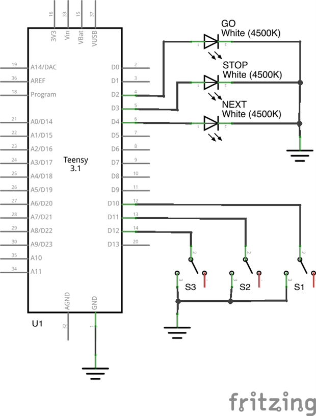

Schematic
The wiring for the controller is very simple. Internal pull-ups negate the need to resistors on the switches. I’ve put together a very rough schematic in Fritzing. Please let me know if you have any questions, comments or suggestions.

When powered up all three of the buttons will illuminate.
The Go button is intended to fire the currently selected cue. To do this it sends a MIDI note to the computer when the button is pressed, and turns the note off when the button is released. During this time the go button will blink 3 times.
The next button will send a different note to the computer when pressed. The LED on this button will extinguish while the button is pressed.
The Stop button has two functions. QLab will fade all active cues when the ‘Panic’ button is pressed. The time of this fade can be modified in the preferences. If the button is pressed a second time the track will stop immediately. To reflect this, the first press of the stop button will cause the button to flash for three seconds. the second press will cancel the flash and re-illuminate the button.

The enclosure front was cut to accommodate the three buttons, the rear face was cut to accept the panel mounted USB receptacle (apologies for the lack of photos). Each of the Buttons was installed and four cables were run to each of them. The Teensy and wire ends were then mounted onto a piece of strip-board
The inclusion of the specific Bulgin connectors are purely optional, I chose them because the USB cable can be ‘locked’ in place, and a standard Mini USB can also be accepted.
