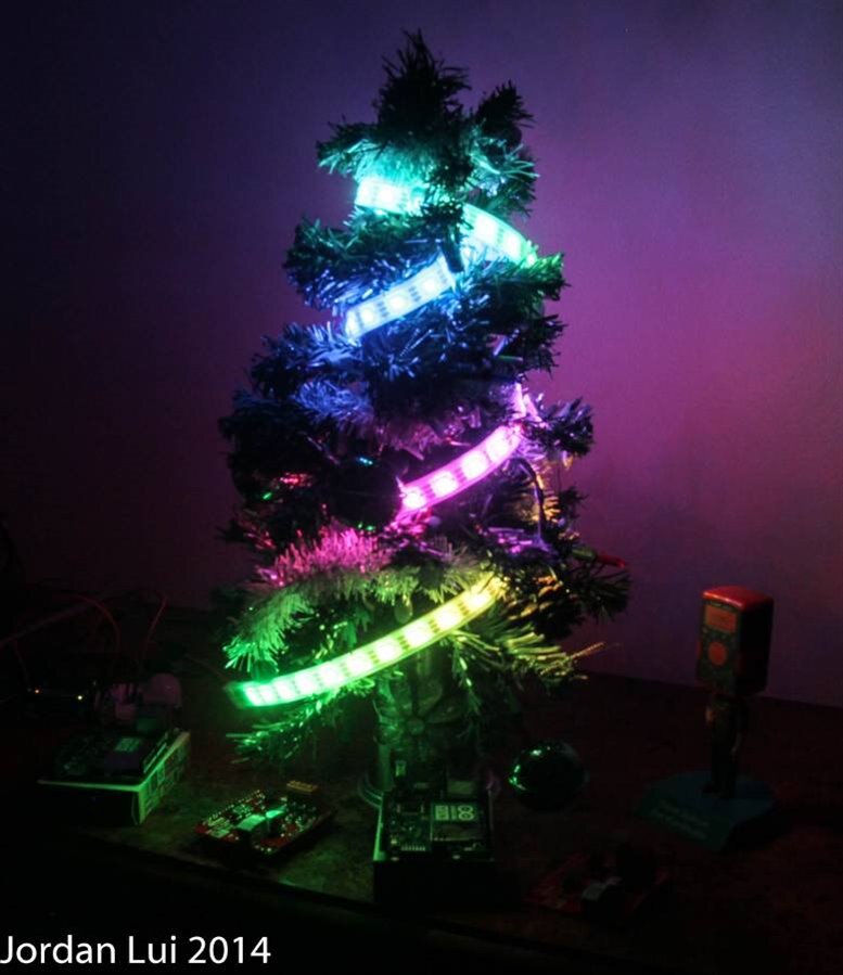

My progress through the IOT RoadTest was an interesting one. As a new beginner to the Arduino platform, I had to quickly learn some of the basics so that I could hit the ground running. I got a handful of components from Peter to get me started and also bought this lovely 60 pixel RGB LED light strip which I have been in love with since it arrived. After running the basic sketches to blink the pin 13 LED light, I then was able to go ahead and power the light strip after learning how to configure the Adafruit NeoPixel library. The result was a very rewarding mixture of brilliant, rich coloured light. What I didn't realize until much later is that I was actually improperly grounding the data line so the signal noise was adding extra rainbow to my display!
It was easy to get addicted to Arduino after seeing pretty lights like this. I was hooked!

As the deadline was quickly approaching, I realized that the key to my project was accepting inputs from the environment and triggering changes in the lighting sequences. So I went with the simplest approach that I thought I could do with my crucial, remaining hours. I used a PIR sensor and a basic script to ensure that I was able to properly harness this little guy, and then tested the PIR with a single LED light:
The PIR is working! The next step after shiny-flash lights was learning how to make this thing accept input from sensors
After getting the PIR to work, I got help from Robert Peter Oakes and leveraged a darling little Arduino sketch which cycles LED sequences. He showed me the intricacies of the code and it is quite glorious: It is built to accept string commands that are then checked against an array of possible commands and then executed. While my application was much simpler (for this time at least!), I was able to run a simpler version that gives me the result below!
My final product is an odd little Christmas tree with a lot of light power! The presents under the tree are the Yun and Infineon boards which I'll be learning more about into the future!

  • ipv1
    ipv1 over 11 years ago
    Nice. Are those neo pixel strips?
