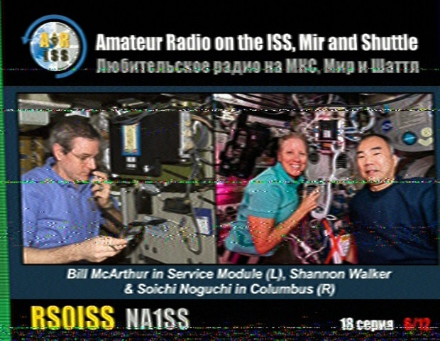

This is a Slow Scan TV image (SSTV) I captured.

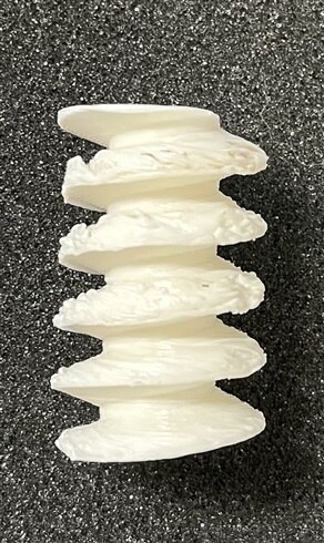

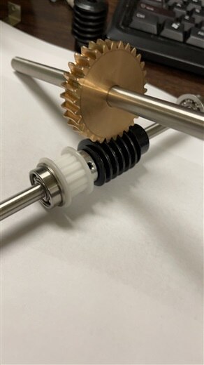

I tried to 3d print the worm gear and failed badly.
I'm now using metal gears.

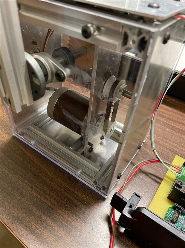

The elevation rotator is almost complete, and I will be using the Phoenix Contact enclosure I'm road testing for the controller.
The controller will be an Arduino of some sort, along with a stepper motor controller.

    Yes, getting the gears to mesh correctly is always a challenge.

    My ability to drill two holes and have them line-up would create a challenge in such a project. The enclosure looks professionally done. Good luck.
