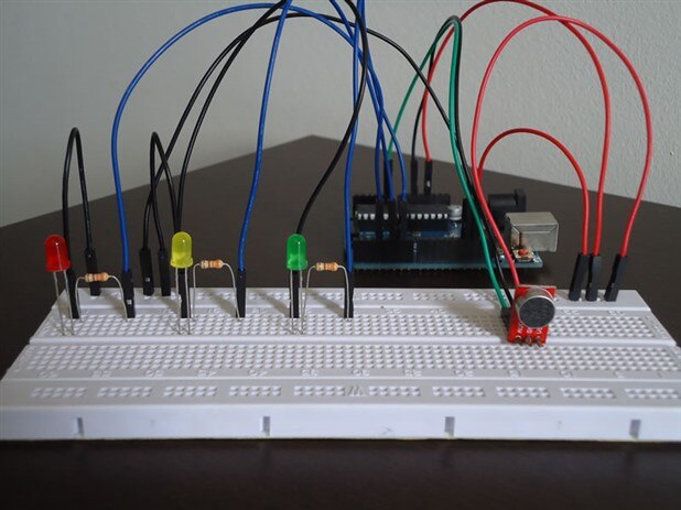

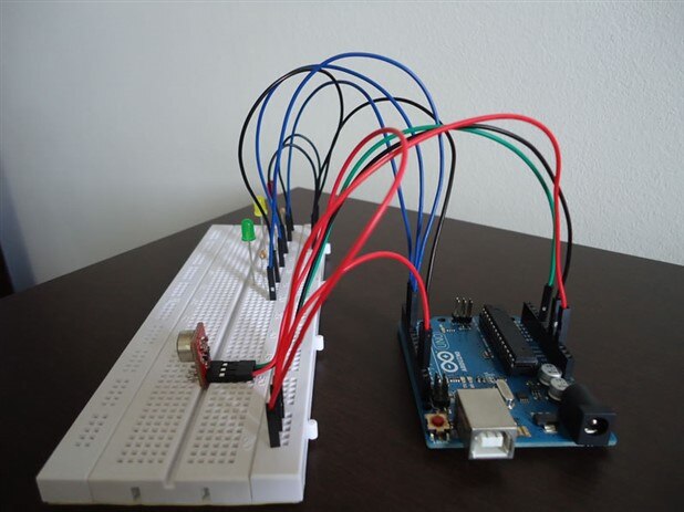

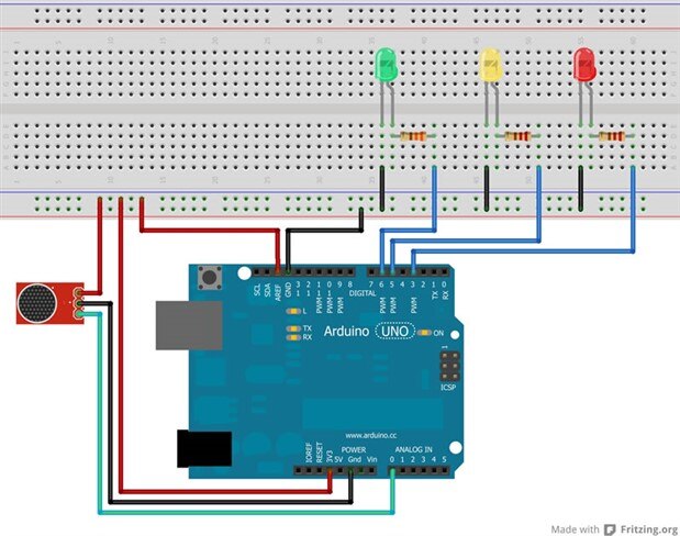

In this project I use BitVoicer’s speech recognition features (http://www.bitsophia.com/BitVoicer.aspx), one Arduino board and one electret microphone (https://www.sparkfun.com/products/9964) to control a few LEDs.
The following fritzing schematic shows how I wired my Arduino board:
I’m also adding a few pictures and a YouTube video of the project running.

The BitVoicer Voice Schema I used can be downloaded from: http://www.justbuss.xpg.com.br/BitVoicerTest2.zip (you need to have BitVoicer installed to be able open it).
Now I want to control a few things (lights and ceiling fan) at home. Suggestions on how to connect them to the Arduino are very welcome.
