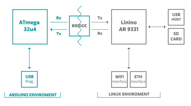

The Arduino Yun is a 2 part device, half a conventional Arduino micro controller and half an embedded Linux using OpenWRT/Linino with Ethernet and Wifi connectivity.
Because there is an operating system as well as application code on the Linux side there is a need to keep that code up-to date. This guide compares the different techniques and discusses when best to use each one.
The Linux portion is made up of the software components, the boot loader (U-Boot), the Kernel and the Applications/Configuration. Reflashing the Yun will update all of these so you will loose your configuration and applications. For the applications it is possible to upgrade those independently using the package manager OPKM.

    It's also possible to see the boot process and directly interact using serial over the micro USB socket if you've installed http://www.arduino.cc/en/Tutorial/YunSerialTerminal you need that for the U-Boot approach.
    I've not used the USB type A socket, is that attached to the Linux side of the Yun? I'm guessing you could use it for thumb drives, keyboards , mice etc...

    Nice. One thing to note on the SSH approach Is the Linaro is connected to the host USB (wield shaped) and not the programmable USB most people expect. Therefore If you use the latter, a serial sketch needs to be running using bridge code to talk to Linaro system. IMHO this is a very nice tool to play.
