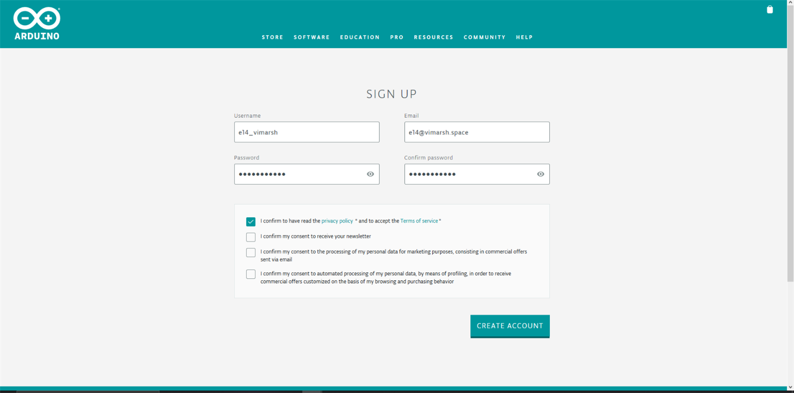

  • Setting up an account
    • Create an account
    • If you have an account then login with your credintials or signup
    • Enter your details (for Signup)
    • Verify your email address

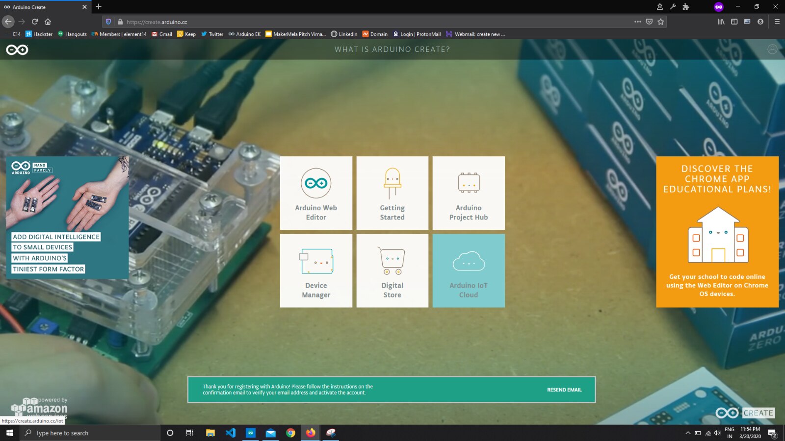

    • Now after logging in, Click on Arduino IoT Cloud
    • You can also choose several plans
    • After you open IoT Cloud you will see this.

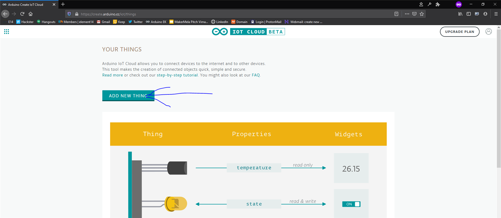

  • Adding a board
    • Click on add new thing

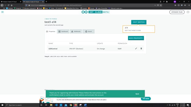

  • Creating a small LED Control Property
    • Now make a new property as this one for simple control of an LED

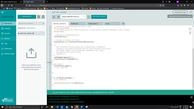

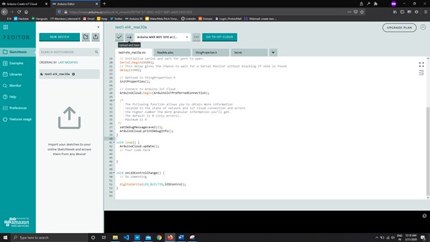

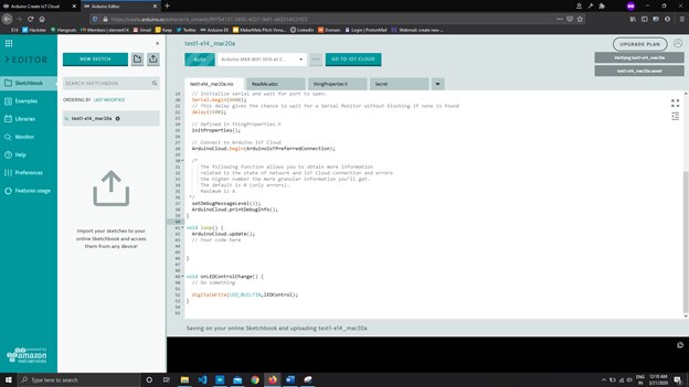

    • Now click on Edit Sketch
    • You will see the online code editor open

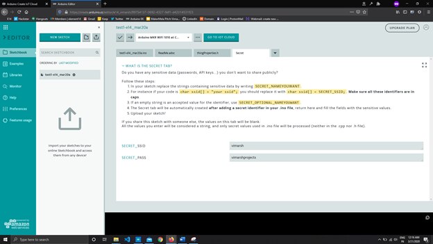

    • Click on the secrets tab and add your WiFi SSID And password

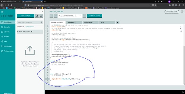

    • Then go to main sketch and add these lines here:
    • Then click on upload
    • Let it wait for some time as the code complies and flashes the board.

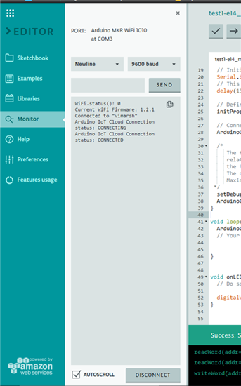

    • Then click on serial monitor to view:
    • You will see the updates being printed.

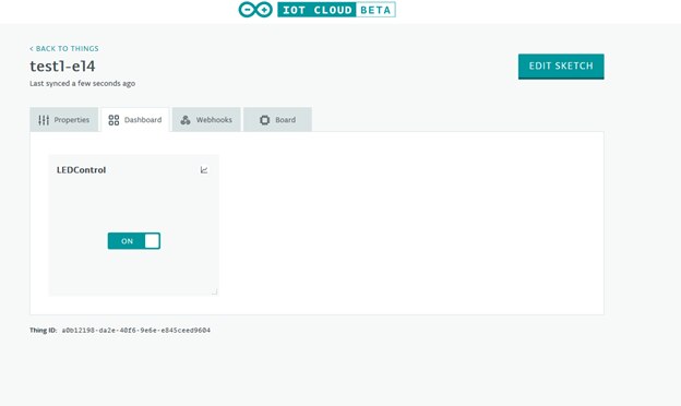

    • Now go back to IoT Cloud, and click on dashboard
    • Now you can control the LED (i.e. the built in LED) on the Arduino Board

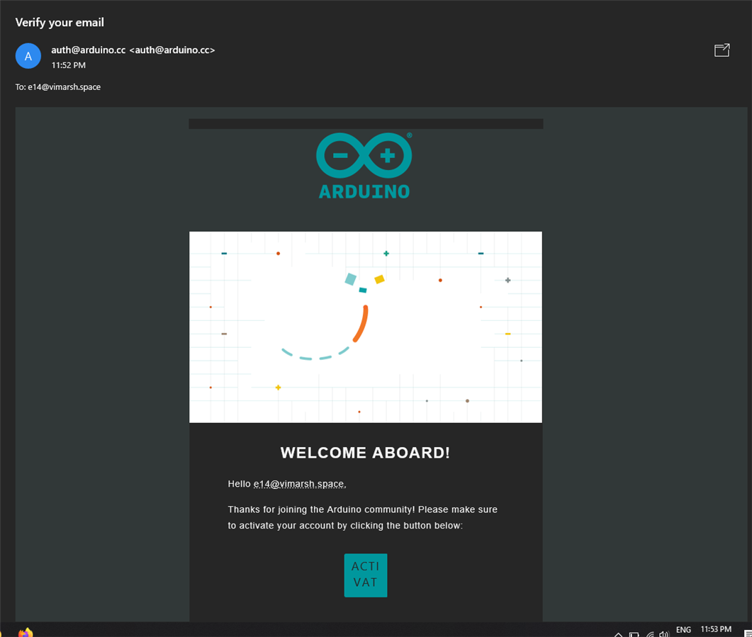

Create an account

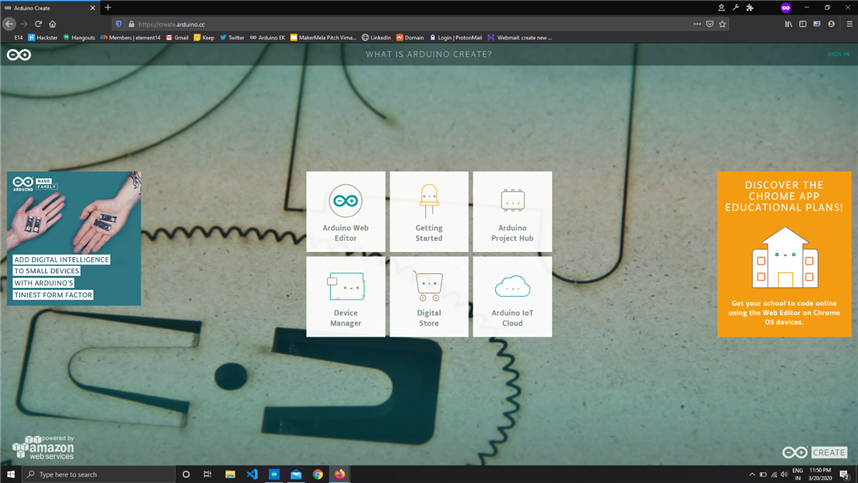

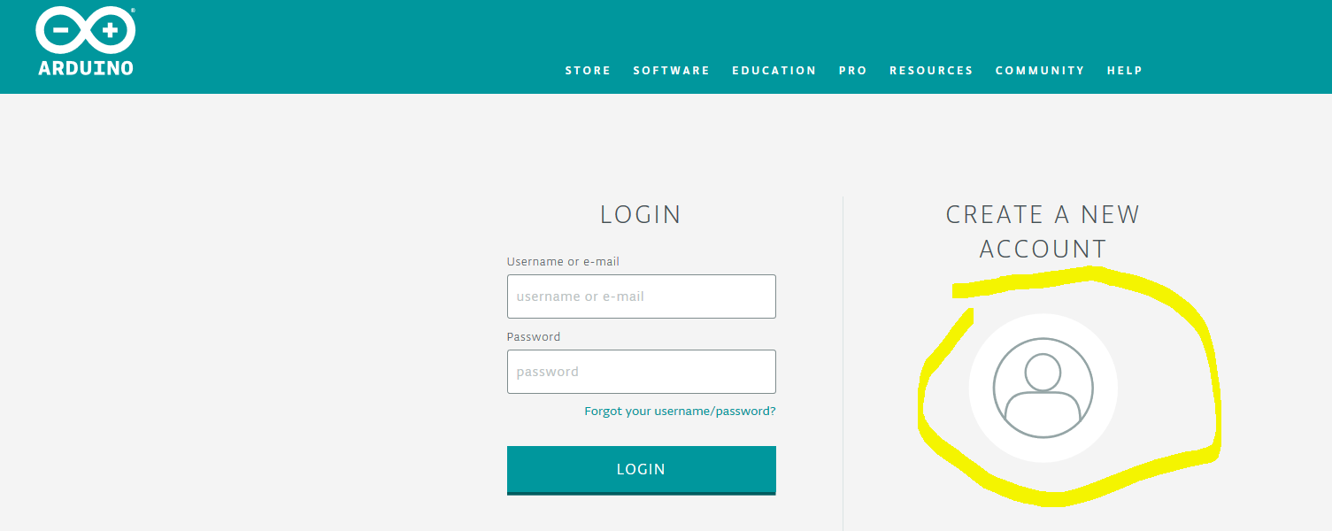

Open create.arduino.cc
Click on Sign In

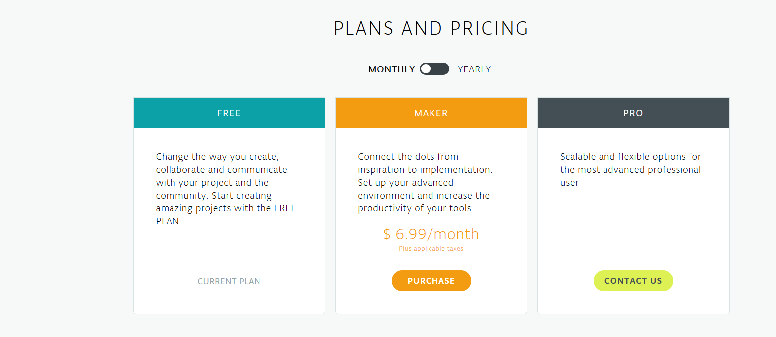

I would suggest to go with free for experimentation

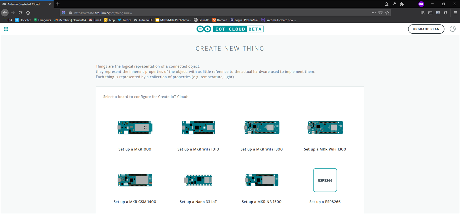

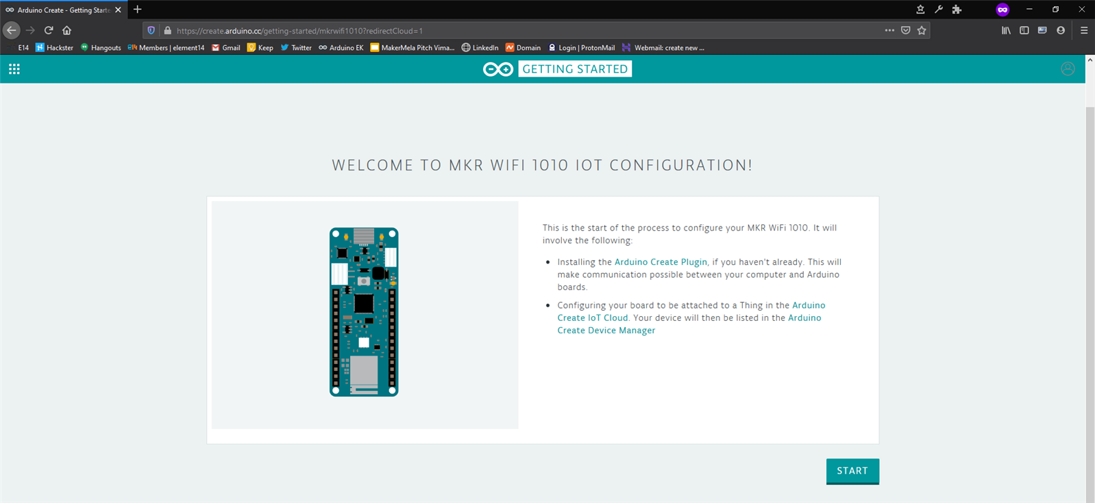

Adding a board
You can select any of the available boards that you have. I have MKR 1010 so I choose that.
Then connect your board to your computer via USB Cable
<pictures>
Follow the steps shown
I would highly recommend using the Cloud Editor for which you need a lightweight Arduino Create Plugin. With that you will not need to install libraries, boards, etc.image
See the video for the configuration process, assuming the Create Plugin is installed.

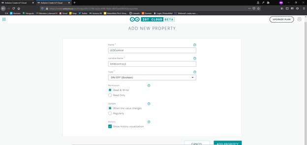

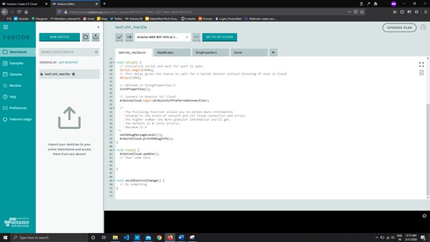

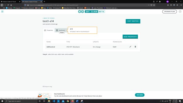

void onLEDControlChange() {
  // Do something
 digitalWrite(LED_BUILTIN,lEDControl);
You can see my sketch here:
https://create.arduino.cc/editor/e14_vimarsh/99754137-0692-4327-9df1-d42014531f23/preview
