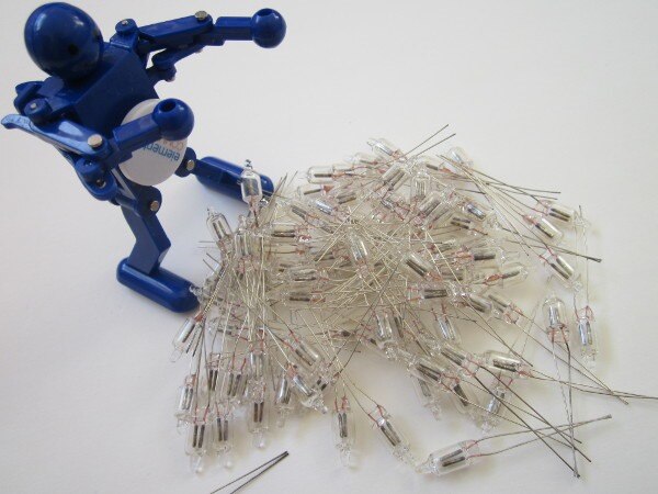

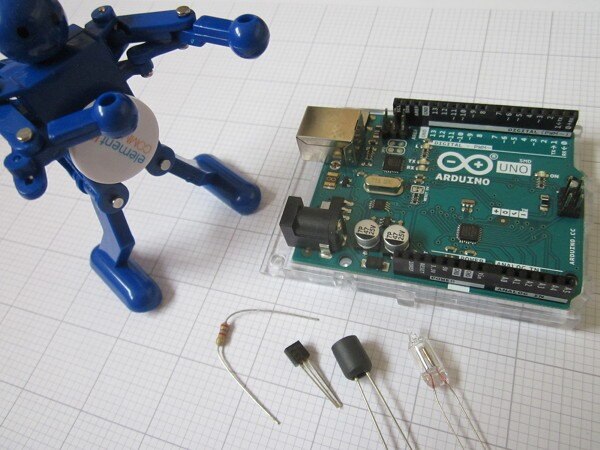

Recently, I received a swag pack that included an UNO and a Blue Man so I thought I'd do a very short and simple experimenting-type blog that could, maybe, lead on to something seasonal.
Here they are, the BM and UNO, along with some of the components I'm going to use: a 2k7 resistor; an MPS42A transistor; a 10mH inductor; and a neon bulb.
I'd previously found a bag of neon bulbs that I must have bought for something or other and then never used.

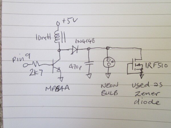

To get the neon to light up, I'm going to need to generate a fairly high voltage. Although I was going to try it with just the components shown above, I then chickened out and added a bit more protection. I didn't know how long it would take the neon to strike, so there was the possibility the voltage might damage the transistor and, once that was gone, might even go on to cause damage to the input of the 'scope. I didn't care about a single, dead transistor, but I do care about my oscilloscope. So I thought of adding a zener to clamp the voltage but didn't have anything suitable so I fell back to using a MOSFET (IRF510) as a zener.
Here's the circuit I ended up with.
[Transistor type should be MPS42A.]

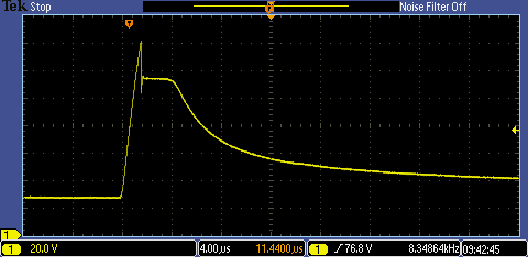

The circuit is a very crude boost converter. The UNO turns the transistor on for about 60us and that allows the coil current to steadily ramp up. When the transistor turns off, the coil generates an emf to keep the current flowing so that it can 'discharge' the energy that is stored in its magnetic field.
Of course, it then dawned on me that I might as well have used the MOSFET as the switch and not bothered with the BJT at all but I left it as it was.

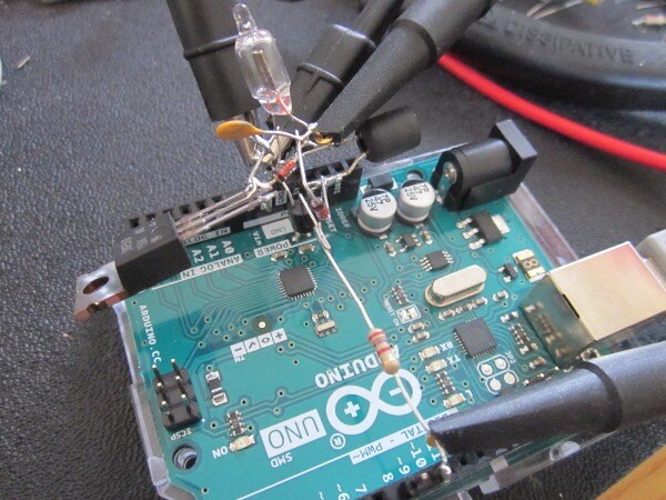

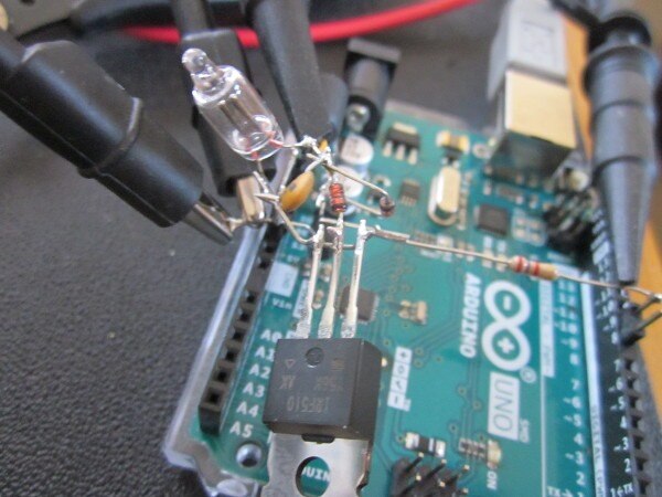

Here are a couple of shots of it 'bird's nested' above the UNO.

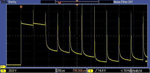

Here is the waveform as it starts off
The spikes are the points where the transistor turns off and the voltage leaps up. The first two times the neon doesn't strike and the voltage is being clamped by the zener [MOSFET]. On the third cycle, the neon strikes and, from then on, the warm, ionized gas strikes every time. I put the small capacitor in the circuit to give the neon a helping hand at the start. It isn't enough to power it through a cycle but it keeps the voltage up at the start and allows the gas to ionize - without it, the neon doesn't ever get started.

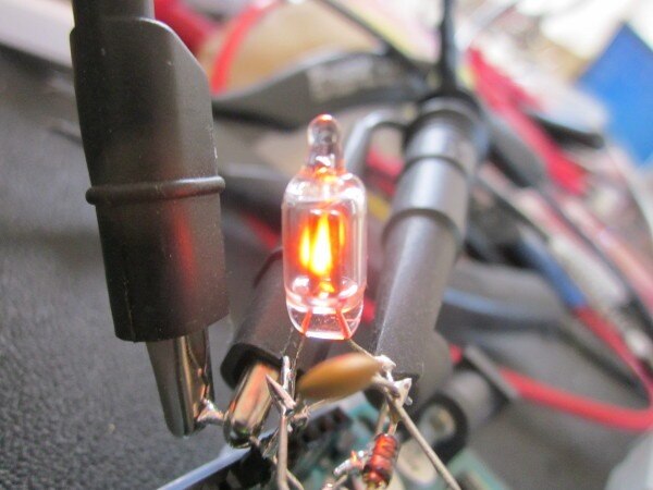

Here's what it looks like when it's running
Although it's non too clear from the video, because I'm driving it with dc the glow is only around the negative electrode (the lefthand one in the picture below):

    This trace shows the coil current (yellow) and the pin 9 output (blue):
    When pin 9 is high, the transistor is on, the coil has 5V across it and the coil
    current ramps up from zero. With a 10mH coil, it gets to 50mA after about 100us.
    You don't want the ramping up period to go on too long or you'll get to the limit
    of what the transistor can manage (a few hundred milliamps).
    The time driving the neon is then quite short, about 10us, so I could have had a
    shorter off time (my 60us was a bit of an arbitrary choice).
    The standard PWM period on the UNO is something like 500Hz, unless you reprogram
    the registers directly, so it would give a much longer off period. But if you sped
    it up, it would be the ideal way to do this as it would give precise timing in the
    background.
    Reviewing what I've done here, it looks like I might have done better with a 1mH or
    2.2mH coil over about 10-20us (which is still quite manageable for a micro doing
    the timing).
    It's also noticeable that quite a lot of the energy is going to the zener clamp and
    not the neon (the neon current is only getting to 20mA, or so, whereas the coil is
    pushing out about 50mA initially). So not a particularly efficient circuit.
