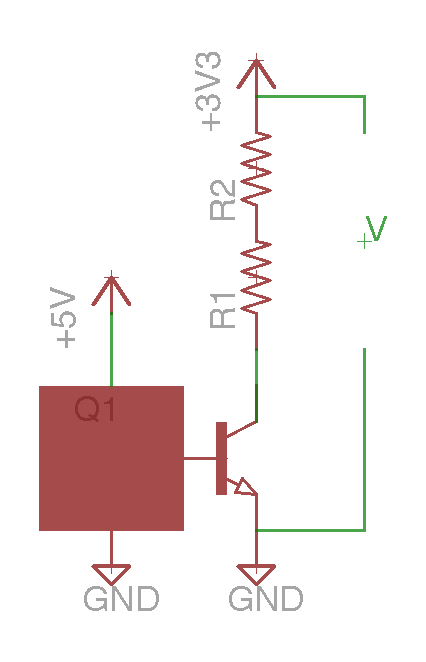

The tricky part comes when trying to measure the voltage drop across the resistor. Voltages can be measured using the Arduino analog pins A0-A5. They measure a voltage up to 5 V with respect to the Arduino ground. However, the voltage drop across the resistor cannot be measured relative to it. Let's try to understand why. In the figure below you can see a schematic of our circuit.
The magnetic sensor is represented as a box connected to the ground and the 5V pin of the Arduino board. The sink is in fact a transistor that conducts when a magnet is close to the sensor and does not if the magnet is far from it. It is connected through a chain of resistors to the 3.3V Arduino pin. If you try to measure the voltage between the ground and the resistor lead connected to the Arduino pin you always see 3.3 V, irrespective of the presence of a magnet close to the sensor, since such a potential is always there with respect to ground.
If, however, you measure the voltage drop across the resistor, i.e. as shown in the picture below,
you would see 0 V if no current is drawn from the 3.3 V pin to the sink, while you can measure 3.3 V in the opposite case. We must then measure the voltage difference between the leads of the resistors. To do that we can measure the potentials V0 and V1 at the two leads of the resistor with respect to the Arduino ground and obtain the voltage drop as V=V1-V0. We can, then, measure the voltage V0 connecting one lead of the resistor to the Arduino A0 pin (blue wire), and the voltage V1 connecting the other resistor lead to the Arduino A1 pin (orange wire).image
magnets
When no current flows through the resistor the difference between the reading of A1 and A0 will be zero (or very small, because of possible fluctuations in the measurement). If the difference exceeds a given threshold, then, a current is flowing into the resistor, then an external magnetic field has been detected by the sensor.
