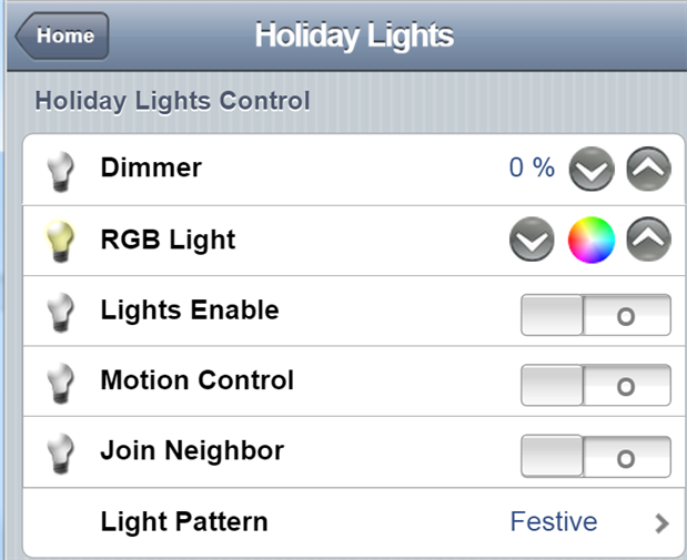

So, in the mean time, I've been working on some automation stuff with lights (when I get them).  I've always wanted voice control, but something that is continuous, and does not require pushing buttons prior to the voice command.  I found out about how Tasker can send HTTP Post/Get commands to OpenHAB.  Tasker also has a plugin called Autovoice, which can run in "continuous" mode, so it will always monitor your voice.  So here's an example of how to do this integration.
Here's the holiday lights screen.
Video of a quick demo.
This video is unavailable.
I have an item defined this way:
Switch itm_holiday_on "Lights Enable"

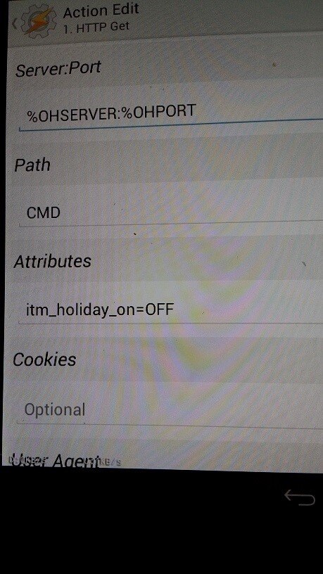

Under Tasker, define a new Task to turn off the switch.
New Task > Action > Net > HTTP Get
Server:Port
OpenHABuser:OpenHABpassword@192.168.x.x
Path
CMD
Attributes
itm_holiday_on = OFF
Do a similar task for turning it on, but just replace the attribute with "=ON".  You can test the task by using the play button at the bottom.  Executing these tasks should turn the switch off or on.
