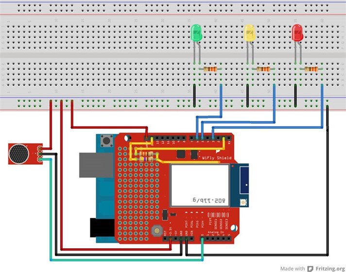

In this project I connect my Arduino Board to a WiFly module (https://www.sparkfun.com/products/10822) from Roving Networks and stream audio to the PC, so that BitVoicer (http://www.bitsophia.com/BitVoicer.aspx) can perform speech recognition. By using a wireless module, I managed to add speech recognition features to my microcontroller without the need of a physical connection with the PC.
The LEDs do the same basic things they did in my last project (http://www.element14.com/community/groups/arduino/blog/2012/12/27/speech-recognition-with-bitvoicer-arduino-and-a-microphone), but now I eliminated the PC wire connection, so I can finally have a speech activated Arduino anywhere my wireless network reaches.

I used a WiFly module from Roving Networks (https://www.sparkfun.com/products/10822) because I read somewhere that it would work with the XBee Shield I had (https://www.sparkfun.com/products/9976). Unfortunately, I found out the hard way that a diode between the Arduino TX and the WiFly RX was blocking the signal. I had to rip out the diode and add a voltage divider between the TX/RX pins of the Arduino and the WiFly module because the RX pin of the WiFly is 3.3V tolerant and the Arduino TX works at 5V. It does not seem to be the best approach, but it worked and I was able to send and receive data from the module. I found out that Sparkfun released a new version of the XBee Shield (https://www.sparkfun.com/products/10854) and that the diode level shifter was replaced with a more robust MOSFET level shifter. This should solve the diode problem.
This is how my project looked like after I added the voltage divider:

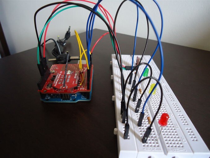

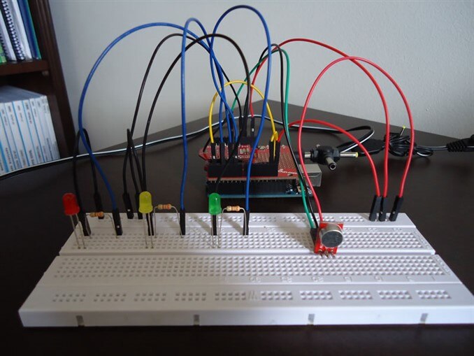

Here are a couple of pictures of my project:
