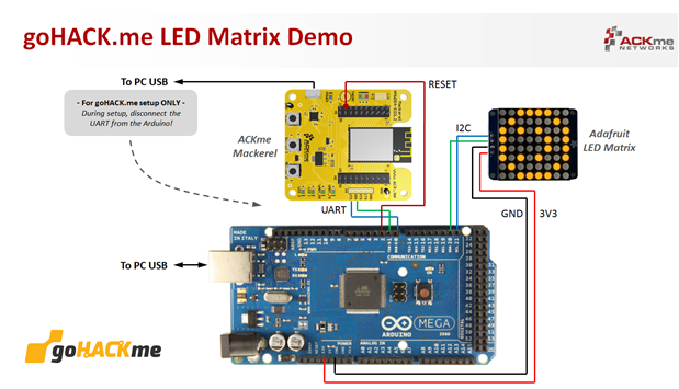

A fun new project for you Arduino enthusiasts!
The code, a block diagram and a photo are posted below. enjoy!
SUMMARY
This demo is a wireless display that can be updated remotely using a web browser on your phone, tablet or PC connected tohttp://goHACK.me
HARDWARE
  • Wi-Fi AMW004-E03 Mackerel board from ACKme Networks
  • Display 1.2" 8x8 Matrix LED from Adafruit
  • Arduino: Mega2560 (other Arduinos ok too, but must be 3.3V)
DESCRIPTION
After the Mackerel board has been setup with goHACK.me, the app connects to goHACK.me via Wi-Fi and retrieves messages and control information such as:
  • Text rotation
  • Text Blink
  • Display Brightness
  • Display On/Off
SOFTWARE & DESIGN FILES
Download link: goHACKmeLEDMatrix.zip
