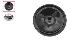

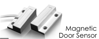

Hello, so I am currently doing a mini project which uses a microcontroller (Arduino Uno Rev 3) and a few modules which I will list below. Whenever I try to assemble the modules altogether and power them through the Arduino Uno 5V Power In & Serial Port for Loading Program, the modules seem to be switched off in a way that there is not enough current flowing through all of them. My project will have to move around so I wont be able to use DC Adapter 9-12V. Are there any alternatives for me to power up all the modules + my arduino uno board? Is it possible for me to power up my Arduino Uno with a power bank?
The modules I am using are:
1. Bluetooth Module, HC05
Operating Voltage: 4V - 6V (Typically +5V)
Operating Current: 30mA
2. Ultrasonic Sensor, HCSR-04
Operating Voltage: +5V
Operating Current: <15mA
3. Speaker (Quantity I will be using: 2)
Impedance: 8 Ohm +/-  15% at 1kHz 1V
Input Power: 0.5W
Handling Capacity: 1W
Buzz, Rattle must be at normal sine wave of 2V.
4. Door Magnetic Switch Reed aka Magnetic Switch Reeds (Quantity I will be using: 3)
Operating Current: 0.5A (Maximum)
Operating Voltage: 100VDC (Maximum)
5. LEDs (6 LEDs are connected in parallel)
Information is based on each Red LED.
Forward Voltage: 5V
All the modules are connected to a COMMON Ground & VCC.
Please help me image
How to power up my microcontroller without the use of ADapter as it is not practical enough for my mini project as my product should be able to move around.

    If you appear to be "amping out", my first thoughts would be: Do you have a current limiting resistor on line with your LED? How are you hooking up the speaker? For powering with mobility, the answer is…

    Any USB power adapter or USB battery module should be able to power your system. If the reed switches are just inputs to your UNO they would only consume a very minor current, potentially just the internal…
    dougw over 6 years ago
    If the reed switches are just inputs to your UNO they would only consume a very minor current, potentially just the internal pull-up current.

    For powering with mobility, the answer is to get the largest Amp Hour battery of which size you can tolerate.  Here's a beast similar to one I've used for running things for a few days.  I like it because it doubles as a good battery for camping trips.
    Depending on the voltage of the battery you select, you may need to put in a DC-to-DC Buck Converter to get down to the Voltage tolerance of the Arduino.
