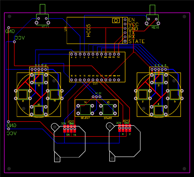

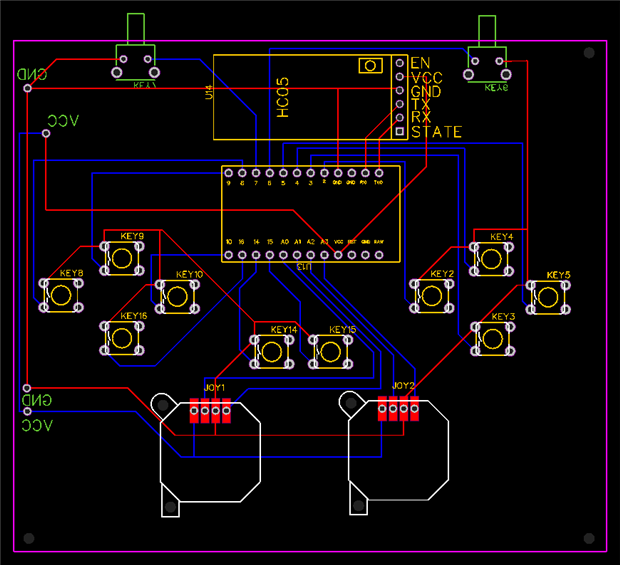

I recently started working on a bluetooth gamepad. I will be using a arduino pro micro + HC-05 controllers. The Gamepad will have 2 trigger buttons, 4 direction keys, A,B,X,Y, start, select, and two analog PSP joysticks. I have a 100mmX120mmX25mm metal box that I plan on using as the casing for the gamepad for now. While waiting for my parts I decided to make a PCB layout for the gamepad.  I have little to no experience in PCB design (or in-depth understanding of electronics involved), hence I came here to share the design for feedback. This is my first electronics project and I am very excited to work on it. The device will be detected as a HID device on various systems thanks to, https://mitxela.com/projects/bluetooth_hid_gamepad  . To be honest, I still don't know how I will go about coding the pro micro but I am sure I'll figure it out over time.

    Made a few changes. Updated PCB

    Okay, so I have some confusion. One end of each switch is connected directly to a digital pin. The other end, should I apply Ground them or should I attach them to VCC? I have seen some people use resistors, should I also add them and if so then where? Can someone explain with an example switch?

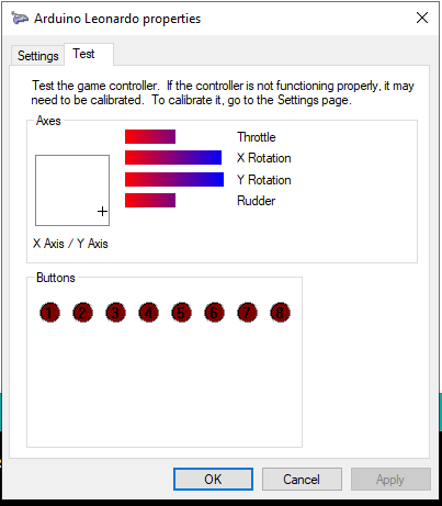

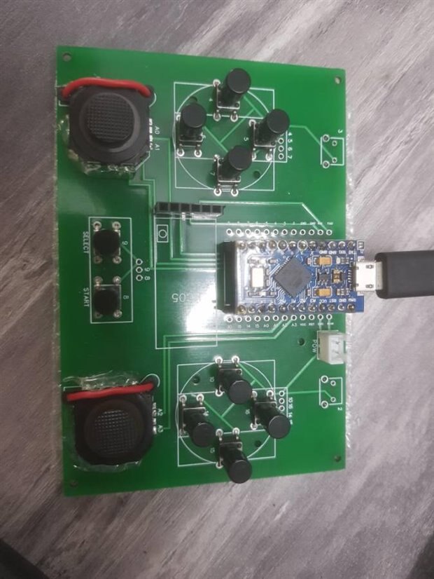

    UPDATE: I am done with the PCB design. It's much more compact now. I received the PCBs recently and immediately started working on them. Some components are still on the way but for now I have a working wired gamepad. The analog stick inputs are currently very noisy. I didn't solder them because I only have two analog sticks and will save them for when everything is finalized. Getting components has become increasing difficult recently because of the ban on Chinese products in India.
    I was able to modify my HC-05 such that it was being recognized as a gamepad on my system. Unfortunately I somehow managed to brick it and I am no longer able to modify it using AT commands.

    devershigpt6 over 6 years ago in reply to devershigpt6
    I decided I will use INPUT_PULLUP option when declaring the buttons. The other end will be grounded.
    dougw over 6 years ago in reply to devershigpt6
    Nice looking card.
    Does the HC05 still work and just unable to alter settings, or is it sending garbage, or is it doing nothing?
    (Did the baud rate get accidentally changed?)

    I am done with the wired gamepad of things. Wrote a blog about the process aswell XD.
    Here's my blog.
