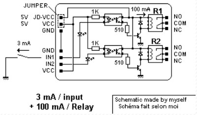

    Your question is reasonable and the answer is yes. If the relay module, I purchased from the Asian distributor, schematic reads correct, there are back EMF diodes installed on the relay.
    The 5VDC button press is detected on Arduino D8 which generates a D6 LOW, among other things to trigger the relay.

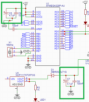

    Jan Cumps over 5 years ago in reply to colporteur
    colporteur  wrote:
    Break...Break...
    I have a common 12VDC power supply feeding the Arduino nest. The switching power supply output has a 2amp capacity. Should I be putting a decoupling capacitor at the power input to each Arduino? I see people include it in their designs. It is not something I have done but in light of recent false triggers I'm reflecting on best practices.
    The Nano and UNO have local buffer capacity.

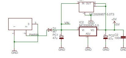

    Nano:
    UNO :

    Sweet! Thanks JC. My knowledge level stops well short of this. Great share. Now why didn't I think of looking for a schematic?
  • colporteur
    colporteur over 5 years ago in reply to Jan Cumps
    In reviewing the schematic I have a question I was hoping you might be able to answer. My understanding was that D13 was connected to an internal LED. In this drawing D1 appears to be connected to an internal LED. What board does the schematic reflect?
    This is a tiny part of a UNO schematic, just to show decoupling capacitors. It's the power LED.
  • colporteur
    TKS for the response. I will and did a search for schematics for Nano. After culling a considerable number I found one that gave me further insight into the current boards I am using. Much appreciate the insight.
