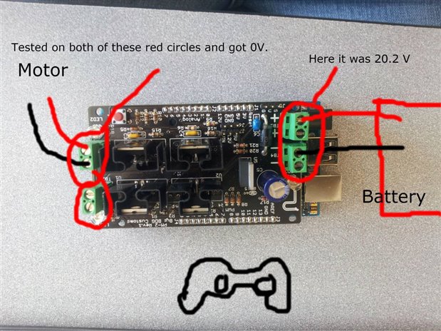

I am using an Arduino ADK with a motor control plugin (the thing with several pins that sits on top of the Arduino board), and I have the arduino connected to a PS3 controller via bluetooth.  I am sure that that part is working properly.  However, when I connect a battery to the plugin and then connect a DC motor on the other end, I find that the controller does not do anything.  Further looking into it, I checked both ends with a meter.  The battery was putting out 20.2 V, whereas the receiving end with the motor measured at 0.  I have two of the boards and it is doing it on both of them.  Did I not do something that I should have?  Any help at all would be appreciated, as I need to get this working for a robotics competition in a few months.  Thanks.
    shabaz over 9 years ago +1
    Hi Tyler, Can you supply the information below, and specifically mention what battery you're using, and exactly what/where you're probing (mark it on a diagram or photo) to see your 0V measurement. As…

    peterjcs23 over 9 years ago in reply to Former Member +1
    Hi Tyler You must contact BDG and request a datasheet for the board and any Arduino sketch they offer. Contact_Us This is a guess...The board looks like an H-Bridge and the reason you have no output is…

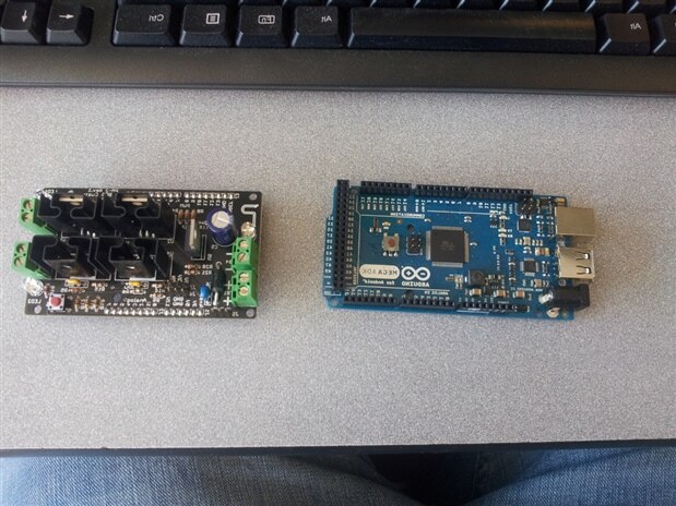

    what is the part number of the motor control plugin?

    Does this help? I couldn't find it.image

    It might help if you flip the motor shield over.  There's frequently manufacturer and model info on the underside of the PCB.
  • peterjcs23

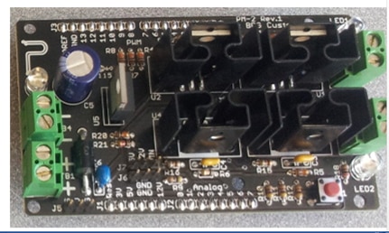

    I've turned your picture round and looked at the motor drive, which actually looks like an H Bridge.
    What does it say up at the top right? PM-2 and something under that. Is there any clue as to the manufacturer?
    Where did you buy it?
    mcb1 over 9 years ago in reply to peterjcs23
    The board shows it was designed by BDG Customs.
    Hi Tyler
    Contact_Us
    This is a guess...The board looks like an H-Bridge and the reason you have no output is because the software is not switching the Bridge.
    This is not a guess....You will need all the details of the board to design the switching sequence.
