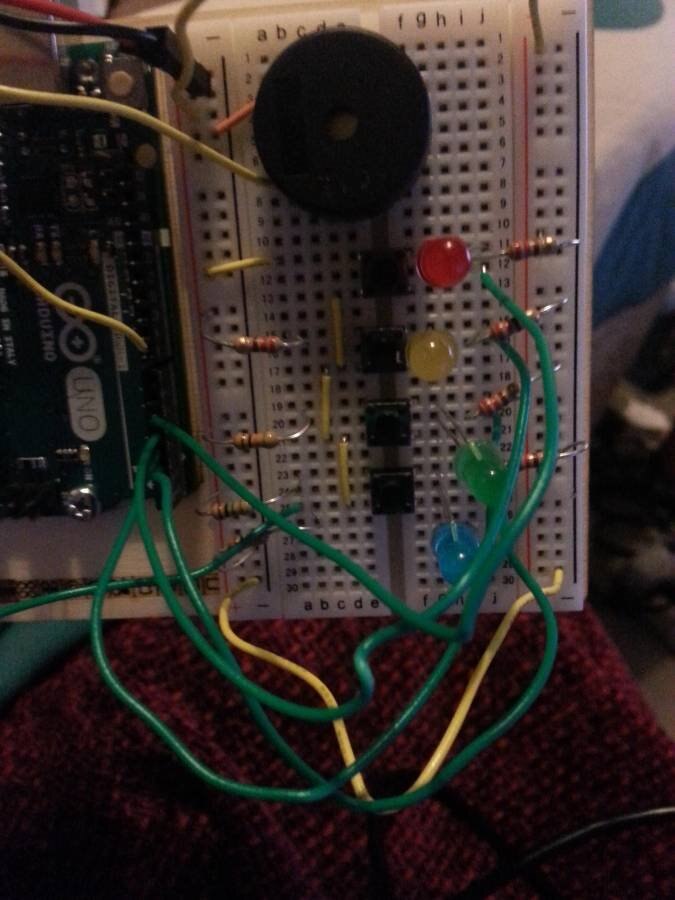

I'm trying to find a way to make LED's flash in accordance with the coding established in Project 07: Keyboard Instrument. I tried setting the pins to the LED's and adding them in the if and else statements for them to activate at the same time the notes do. But I've had no such luck. Could anyone help me understand where I'm going wrong?
Physical Side:
Coding Side:

    Hello, better if you provide a schematics, Jack. No matter if it is done by hand or Fritzing or Eagle. Anyway from the image it seems that your LEDs are connected to the digital output signal and in the…
    Anyway from the image it seems that your LEDs are connected to the digital output signal and in the meantime to the push button signal. This sounds strange, but from the image it is not possible to understand too much for me.

    Do I have to draw up the schematic or is there an easier way of getting it?

    In order to build a circuit you should always draw it or document the connection list in some way. That is part of the design discipline and process. Peter

    I would suggest drawing up a wiring diagram showing the circuit you think you have and check it against what you've built.  I can't exactly tell from the picture you've posted but I think there may be an error there.  At any rate, if you're still having problems post your wiring diagram and someone will catch it.  Also, a description of how the LEDs are behaving and how you expect them to behave would be helpful.  Good luck!

    I agree with peterjcs23, the first things that you have to do is drawing a wiring diagram.
    However if you have to control only four buttons I suggest to use digital read because is faster than read an analog value and also the circuit will be easier because you don't have to make a threshold for every button

    The LED has a long(+) and short leg(-). https://www.westfloridacomponents.com/blog/led-basics-how-to-tell-which-lead-is-positive-or-negative/
    If reversed, no current will flow since diodes are one way.

    Actually that is not the best method to tell.
    Yes if they are new the longer lead is the Anode, but I have seen the internal structure swapped which was really annoying.
    There is a flat on the Cathode side, but it is difficult to see on clear LED's.
