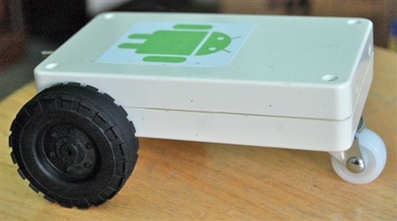

    simon.monk over 15 years ago in reply to e14 Contributor
    ADK and Open Accessory are tethered only, and I supose the rationale is that you are esentially plugging it into a charger that does other interesting things too.
    Obviously not the right thing for a lot of projects. Have a look at Amarino - it takes the pain out of the Bluetooth / Arduino link. I made this little robot using it. Again one of the projects in Arduino + Android Projects for the Evil Genius.
