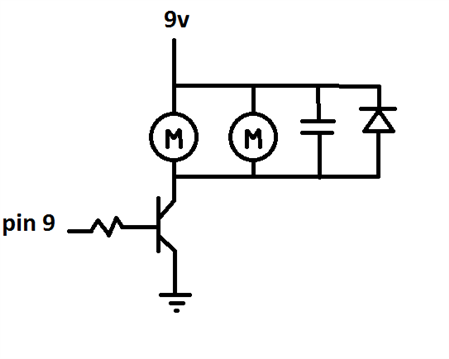

    Ok man thanks alot just one more thing , can I connect not 1 but two motors (parallel) of course I will need a transistor that can support the currnet consumption, but I wont need x2 of the capasitors and the diods

    The cap and diode is for noise and transistor protection.

    dirtdiver over 14 years ago in reply to dmaruska
    so this should be fine then right?image
