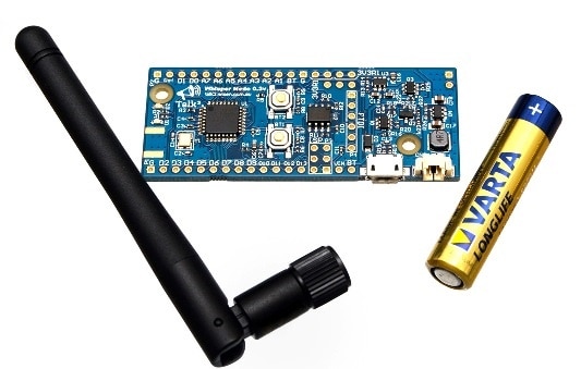

Hi Everyone,
for some time now I've been designing and testing a new Dev board, which I've created to fulfill some requirements I normally have for our projects. I basically need good Wireless communication and, at the same time, be able to run my Arduino for some long periods on standard battery.
For that reason we've created the "Whisper Node", which I'm glad to announce it was successfully founded via Kickstarter and it's now a real product available to everyone. Additional details can be found on the following link: https://wisen.com.au/store/products/whisper-node-avr/
Please check it out, share with your friends and support this project if you believe it's interesting.

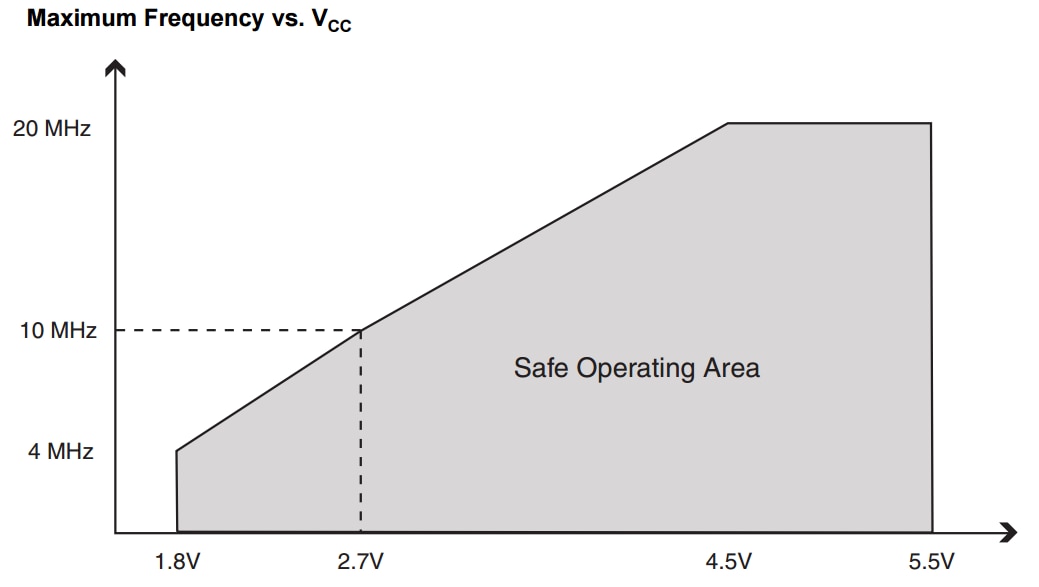

    Using the various sleep modes is probably one  way of increasing the life of your batteries. If the chip supports an interrupt (any line will do that changes state when something of interest occurs will do)
    but after reading a bit about the board
    it is using a 16Mhz crystal, this means it could be unreliable at 3V3 see the chart showing safe operating speed vs supply, it may work on some boards but not others
    Other ways of significantly reducing power is to slow down the CPU, how fast do you really need it to go ?, this of course is application dependent. but will also allow you to reduce the supply voltage. you need to consider the lowest voltage of the other parts though.

    Robert Peter Oakes, you're right about the AVR atmega328p specification, where 16MHz is a bit off (around 3MHz over) the "safe operating zone". For general application I haven't had any issue running project at 16MHz @ 3.3V, including a board running for over one year inside my fridge image transmitting open/close door, temperature and humidity. Anyway, in case you're developing a critical application or if you're planning to run your board on extreme temperatures there's always the option to reduce the MCU clock speed by configuring the CLKPR register. That's basically a CPU Clock pre-scaler and can be easily changed "on the fly" using the function clock_prescale_set ( clock_div_t x ) - http://www.nongnu.org/avr-libc/user-manual/group__avr__power.html.
    The CLKPR register gets the initial value from the AVR Fuse CKDIV8 after boot and it's ok to change any time during your code execution. This is a great feature to save even more energy, and at the same time, speed-up your MCU when required. For example, you probably want full speed when talking to the RF module to save energy when having everything up at the same time. But you don't care much about how fast the CPU is if you just need to "blink an LED for 20ms" as 1MHz will be more than enough to do it.
