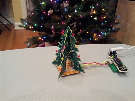

I bought a Velleman 3-D Christmas tree kit but found the fixed blinking pattern a bit boring:
http://www.vellemanusa.com/products/view/?id=351133
http://www.vellemanusa.com/images/products/0/small/mk130.jpg

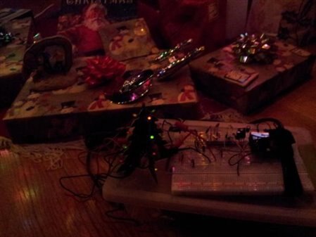

So I decided to mod it by hooking up the switching transistors to digital pins on a breadboard Arduino clone and fading the LED segments in and out with random patterns via analogWrite():
I just wrote a blog post with more details:
http://www.element14.com/community/blogs/pdp7/2011/12/22/arduino-powered-3-d-christmas-tree
Now that I have a working prototype, I look forward to soldering the components on a protoboard attached to the base of the tree to make an attractive holiday decoration.

    Here's a video I just shot to show it cycling through a couple different random PWM settings:

    Just finished this up after a break for SMD LED cards:
    http://www.element14.com/community/blogs/pdp7/2012/01/07/arduino-3-d-xmas-tree-part-2
