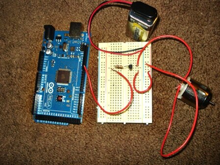

I am working on the first part of tutorial 5 (the first 7 minutes) and am trying to make the motor gradually increase and decrease in speed. The problem that I am running into is that my arduino is not giving my transistor any current. Here is my code and a picture of how I wired everything. Anyone see any potential problems? I would really appreciate any help!

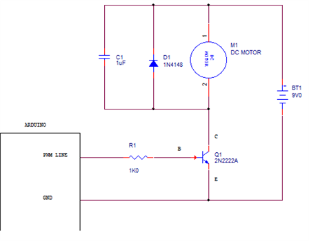

    OK, that helps some. Now we need to see each piece. Connect just the motor to the battery. Does it work OK? If OK, You need to insure that the circuit is wired correctly. I have made a schematic for you…
    Hey, I'm no expert, but here's two things I noticed.
    1. Your code sets digital pin 1 as OUTPUT but your wire is connected elsewhere according to your picture.
    2. You need to connect the ground from the arduino to the ground from the battery.
    Hope this helps. Otherwise I see no errors in your code.

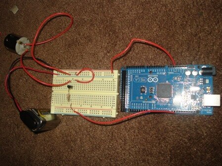

    e14 Contributor over 14 years ago in reply to e14 Contributor
    Thank you. I fixed both of those. Unfortunately I am still getting no output from my arduino image Have I hooked the ground to ground correctly, or could that still be the problem?

    dmaruska over 14 years ago in reply to e14 Contributor
    Hi.  Assuming that you Arduino is working correctly, you have some steps you should take.  one, remove the input from the Arduino at the Base resistor.  Take that wire and place it at the +5v header pin  The Motor should turn on and run at its max speed, with the Arduino powered up via the USB or the Power Plug.  If this is OK then the problem is still at the output pin.  If this is NOT OK, then the problem is the base resistor (too large) or the wiring to the transistor, or the trasistor its self.  I would look at the datasheet to insure that you have wired it correctly.  Good Luck.

    e14 Contributor over 14 years ago in reply to dmaruska
    I took the wire, put it in the 5v pin and it still did not turn on. But I measured with a multimeter and there was current going through from the 5v pin to the base. When I measure from the 5v pin to the motor, i reads -5 volts, but when i measure from motor to the base of the arduino i get 9 volts. Is this a problem with how by bases are set up? How is it possible to get two different voltage readings going through the same circuit? Also, I switched the resistor with a 270 Ohms and it made no difference.
    OK, that helps some.  Now we need to see each piece.  Connect just the motor to the battery.  Does it work OK?  If OK, You need to insure that the circuit is wired correctly.  I have made a schematic for you just to make sure,  I have included a Diode and Cap that goes between the Motor terminals, but for testing they can be momited for now.  But should be included for correct circuit operation (removing noise made by motor).  Make sure the Ardunio GND and Battery GND and Emitter are all connected together.  On the PWM input, try the 5V to the resistor.  Motor should spin.  If not, replace the transistor.  If you have a meter, you can check to see if the transistor is OK.  Check all connections are GOOD.  nothing like thinking you have a bad part, and the wire turns out to be to problem or the solder joint.  I have used a 2N2222A2N2222A transistor, but any NPN that can handle the Current flow for the motor will work.  When looking at the data sheet.  MAKE sure you understand the orientation of the drawing when selection of the Emitter, Base and Colletor.  TO-92 parts have been installed countless times reversed because of the diagram.  Once you have the circuit working with just the 5V, Battery and GND.  Connect to the Arduino PWM line you have selected in the program.  All should be good at this point.  Good Luck. image

    @dmaruska: I'd appreciate it if you let me know what app you used to create that neat schematic, thanks.

  • dmaruska
    I have a license of OrCAD that I do schematics with.  It's a nice tool, could be made better, but I have been driving it since it went from DOS to Windows.  I cut and paste in to paint and post.

  • billabott
    billabott over 14 years ago in reply to dmaruska
    This is TROY!       Actually it is NI Multisim 11.0 Breadboard view.
