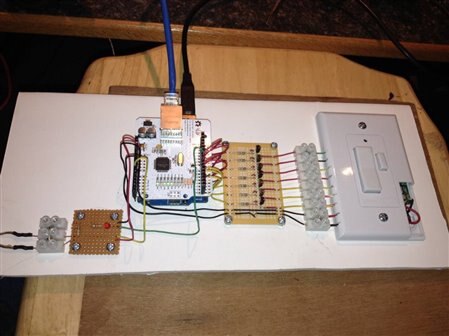

    Here is a project I did, and I have been using this for several months to control several lights in my house.  It uses Heath Zenith remote switches, I hacked one switch to control all the lights.  The Arduino Uno controls the dip swith and on/off/dim buttons.  It uses an ethernet sheild that I control by wifi from my Ipod.  I would think you can find a similar app for the Android.  The app has timers that I can use to turn lights on and off daily or one time.  I also added a photo sensor to turn lights on at dark. I can control the trigger point of the photo sensor from the app.  I mounted all on a peice of foam board and hang it above my PC, kind of electronic art.
    I put the files that show the connections to the switch, a wiring diagram, screen shots of the app, and the Arduino sketch.  You can download it here:

    Additional info:
    == Overview ==
    * Controls Radio Frequency lights switched by Heath/Zenith devices.  Control
    * is from an Ipod by wi-fi through a local server to the Arduino with Seeed
    * ethernet sheild.  The app is Arduino Manager
    * == Operation ==
    * Select a switch to control the associated light, then press the ON, OFF, or DIM
    * button to send the command.  The Dip LEDs indicate the dip switch setting for each
    * switch device.  Only one device can be selected at a time, the other will be
    * automaticly de-selected.
    * The photosensor is mounted on a window facing outside to detect the daylight.  The
    * light level can be monitored by a Message widget or Graph widget. The trigger knob
    * controls the light level that triggers a light to turn on or off.
    * NOTE: Enter a "0" in the Cmd window to unlock the trigger control.  Enter a "1" to lock
    * the trigger.  The sensitivity of this level can be adjusted by the Trigger knob.
    * The photosensor activation switch is named "PsAct", this switch activates the photosensor
    * control.To disable photosensor light control, turn the PsAct switch off.
    * The alarms can be set to turn on or off lights.  The AllOff turns off all lights.

    e14 Contributor over 13 years ago in reply to e14 Contributor
    wow, great post! Exactly what I was looking for, thank you for the download files and diagrams greatly appreciated! Now all I have to do is wait for my house to be finished being built haha. And im not to worried about if they have an app for me on the android market. I should be able to progam one myself I know alittle bit about it haha.
    -Jake
    I don't see the Arduino Manager App for the Android.  The sketch is based on the app example, and was quite a challenge to figure out, so the sketch may not be much use for your project. But it may give you some ideas for your project.
