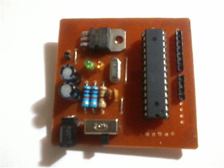

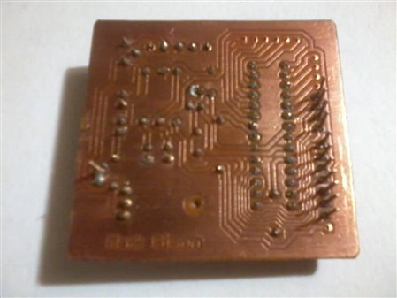

    e14 Contributor over 13 years ago in reply to mcb1
    hello Sir mark,
    sorry for late reply i've been so busy in our proj. at school.. thank YOU so much on helping about this standalone and as well as to "billabot" making this
    standalone 328 possible,. I have also made a shield of it, so i can program it easily using the TONNER TRANSFER METHOD... take a look at this pic. imageimage
