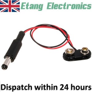

    Just a little update.
    The 9v battery connectors arrived last night and I hooked it all up and loaded on an sketch from the example folder and it runs!
    Really pleased to see it working off the batteries.

    The 9 volts is because some motor drivers won't work below 7v, its just the way they are.
