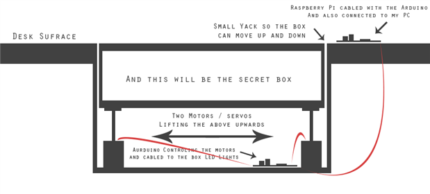

Okay so as i mentioned in the title i want some help with a Project im doing that i named "A Secret Box".
So the problem is that im a big noob when it comes to both the Arduino and the Raspberry Pi so i need a bit of help with everything basically.
  • I need help with what kind of motors to have Pistons/Servos/Steppers.
  • I need help with how to setup the Arduino and the motors (just link a tutorial that i can look at / read)
  • How to connect the Arduino and Raspberry Pi
  • And much more i guess with upcoming problems i will have.
So i have made a little picture explaining my design and purpose of this project.
It's a box cut down into a desk that im going to build for my setup. under the box i have the second box with an Arduino and two motors (maybe more).
I hope this is enough to get some good answers on what to buy because that is my biggest question for this.
I already have the Raspberry Pi and im going to start playing with that when i have time.

    Arvid, your project is easy to implement using linear actuators, there are lots on Ebay. With one of these units you only need an Arduino UNO and a relay or maybe two. You could quite easily implement…

    Hi, I cannot recommend an actuator because I do not know the height and weight you want to lift. The Arduino can easily receive serial commands from any terminal program, CoolTerm is very good, but why…

    Arvid, the requirements of the linear actuator are are straight forward just pick one that is,say, 12 VDC and has a movement of 200mm and able to lift more than 1 kg. Regarding controller the unit from…

    Okey thanks a linear actuator seems like a nice thing to build this out of. Maybe you could link me to a model you think is good / recommend for this build.
    But im not thinking of giving the raspberry any big purpose in the build i will just use it to execute the up and down commands. Because i don't want any button or sensor that those it. Or is there a easy way to do this directly from your own PC with something like a VB.net program?

    The Arduino connected to USB port gets power AND can communicate to Arduino through Putty(a serial monitor program on PC). You could type "up" or "down". Or it can take a secret code only you know! Oh and you could use the Pi instead of PC in same configuration!

    The high will maybe be something around 10 - 20 cm and weight will be around 1kg.
    Also i want to control it from the PC because i think its easier and i dont want a switch that others can click on.

    Arvid,
    Regarding controller the unit from the PC, no problem.  You could look at ‘Firmdata’ (Google ‘Firmdata’ on Arduino) or just use basic serial commands sent from your PC com port using a terminal program (CoolTerm).  When the Arduino receives the appropriate command it will raise or lower the actuator.
    You need to Google ‘receive serial strings on Arduino’ to find code to put the received characters into a string and then parse the result to find the command you sent.  Alternatively you could just use a single letter command such U for up and D for down, you would check the received character and if it was a valid command actuate the actuator.
    You will need a two relays to control the actuator, one to control the power On/Off and one for direction.  These relays should ideally opto coupled types so that only a small current is taken from the Arduino and the power side of the system is separated from the control side.
    you need a DC supply to provide 7-12 input to the Arduino and if the actuator is 12 VDC you need a 12 VDC supply with a current rating about 1.5 times higher than the  actuator rating.  So if the actuator draws 2 amp then you need a 3 amp supply.
    Alternatives to control the actuator are a motor drive board / shield or a H bridge design.
    Google is your friend and lots of information on the items I have mentioned can be easily found.
