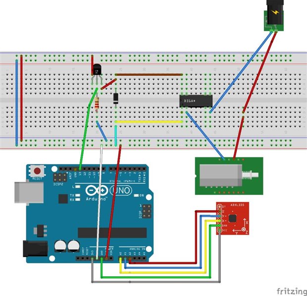

    balearicdynamics over 10 years ago in reply to Former Member
    Ok, I'll check the material as I am back.
    Enrico

  • Former Member
    Former Member over 10 years ago in reply to Former Member
    Please note the big green part represent the lock.
    I am not an expert in elctronics so feel free to correct me
    Yuvish,
    it is my opinion that this circuit - that seems at least well done and set - maybe perfect or crap. It depends on two things: the correct connections between the accelerometer and the other components to the Arduino pins but - first of all - how do you manage with a script the signals, pins and connections - So untile we can't see a line of your code we can't imagine what you are doing with this stuff.
    Enrico
