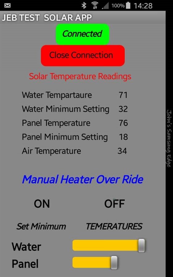

  • alacosta
    0 alacosta over 10 years ago in reply to neilk
    Hi Neil
    just to update and let you see the on going development  from your advice.
    Have now been able to develop this further and will be adding more features in the future
    Data now life   ... note todays air Temp
    again thank you
    Johnimage
  • neilk
    0 neilk over 10 years ago in reply to alacosta
    Hi John
    Thanks for the feedback image looks very impressive - need a spell check on TEMPERATURES..........: image
    I assume the Water & Panel at the bottom of the display are App Inventor Sliders? Nice use of them.
    Glad I was able to help.
    Keep up the excellent work and continue to keep up us updated.
    Best wishes
    Neil
