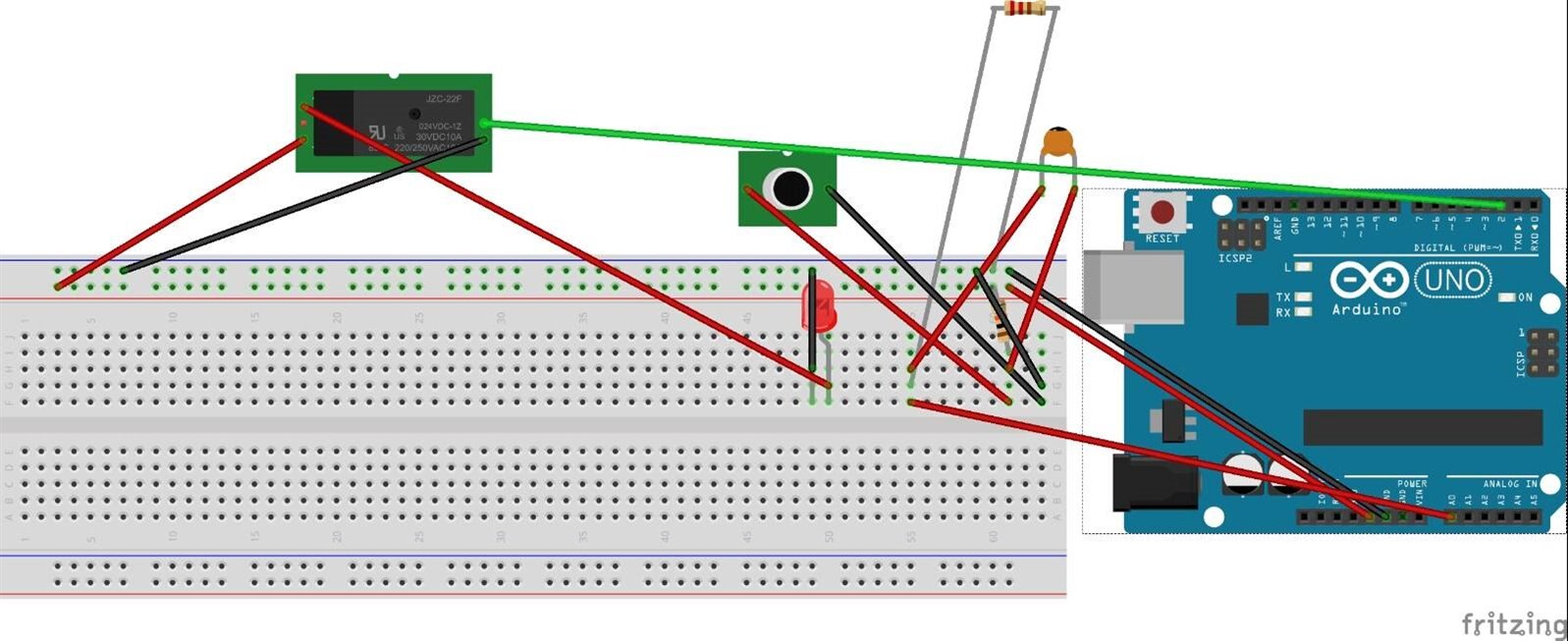

    Sorry for the misuse of the forum, i was being lazy and i apologize.
    I have attatched a schematic i made in fritzing(it's my first one so it might be a little messy, but its legible.  And i have linked a video of the issue.
    the relay turns the led on and off, instead of one clap for off, and another for on, the code im using is also in an above post.  I am really at a loss for what the issue is because if i cut out the relay, and just wire pin 2 to the positive connection of the led, it works just fine, on with a clap, off with another, but when its hooked up to the relay, it just goes on and off with one clap.

    0 jw0752 over 10 years ago in reply to gub11
    Hi Gabriel,
    I suspect that your relay is drawing more current than the number 2 output of the Arduino can supply. The Arduino should drive a transistor, probably a small gate level MOSFET, and the transistor should connect the relay to the main power. Be certain to put a reverse biased diode across the relay coil to protect the circuit and a 470 uF capacitor from 5 Volt plus to ground will also improve the operation as it will stabilize the 5 volt supply.

    thanks, i think somebody also recommended that here, http://linustechtips.com/main/topic/449615-arduino-relay-help/ , is the sketch he supplied going to work
    Hi Gabriel,
    Yes this is the same idea. I suggested the MOSFET as I find they are easier to use than the BJTs. The Capacitor is just an extra precaution but the diode is pretty important to protect the transistor or MOSFET. Give it a try and get back to us with the results.
    0 balearicdynamics over 10 years ago in reply to gub11
    Hi Gabriel,
    I subscribe the hypothesysof jw0752 But let me know a couple of details:
    1. Are you powering the relay with 3.3 V or 5V from Arduino ?
    2. Check the relay data sheet what is the drawing power
    3. Are you using the relay also to power the led when it switches?
    If 3. is true, I suggest that as should be done in the normal use, the Relay is just to use a low power (Arduino 5V) to switch the coil then the other side will use an external power to manage the device. If you leave the circuit as-it it is also possible it works with a LED but it is formerly wrong as the Relay is not used to power anything else (e.g. a motor or a more power device, like a 12V fan).
