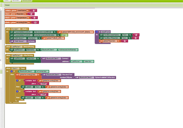

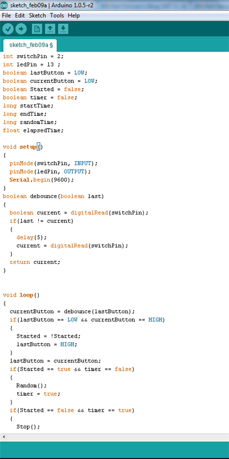

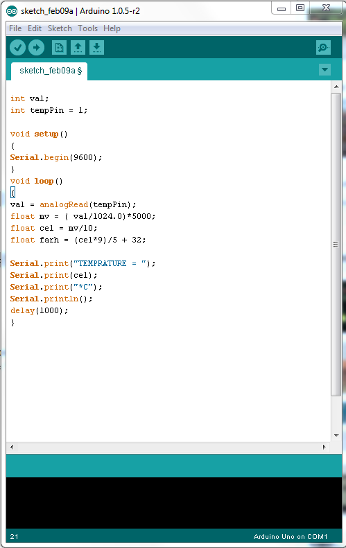

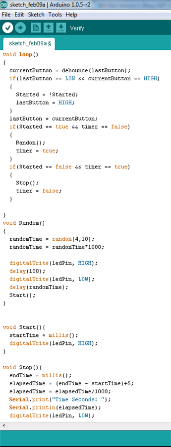

Hi i am wanting to simply split the data that is coming in from my hc-06 module into seperate textboxes. I have my arduino code and at the moment it is putting both the temperature results and the reaction results all in one textbox. Is there any tips on how to sperate these into different textboxes?
Many Thanks
Rhys

    I assume your hc-06 is transmitting to an Android device ?? if so then:
    If you look here : https://www.element14.com/community/thread/44533/l/reading-arduino-csv-data-in-app-inventor
    You will see a similar question from alacosta involving 5 data items, sent out as .csv, which was answered.
    If you look at my blog, here: https://www.element14.com/community/people/neilk/blog/2015/02/02/mit-app-inventor-and-arduino-part-4--send-more-than-1-data-item-from-arduino-to-android-and-display
    You will see several other potential solutions to your question.
    Hope this helps image
    Neil

    This is the two separate pieces of code that i have used but im not exactly sure how to put them together correctly to be able to parse?

    Hi neil, thanks for the response, Im quite new to app inventor so im not sure if what i am doing is right. This block code sends the temp and reaction both to the same label?

    Hi Rhys - as far as your Arduino code is concerned, it's almost impossible to decipher from the screen shots you have included.
    When posting code, it's much better to click "Use Advanced Editor" in the top right of the message window. This then allows you to click the >> symbol and then select Syntax Highlighting followed by c++. This gives the following sub-window:
    You can then type or paste your code like this:

    The solution given in the second link I provided is, I think, superior to the above, because it doesn't rely on timing. If you study it, you will see that it assumes that the Arduino sends data in the form:
    LED = 135,LDR = 245
    and uses an App Inventor block which splits the incoming text into a list, using the , separator. Each item in the list is then independently accessible.
    As a general rule, I would always start with a known, simple example and get that working first!! Then you can slowly convert it to your own requirements, retesting it at every stage and including lots of comments and Output to the serial monitor so you can understand what's happening when it stops working!
    I hope this helps.
