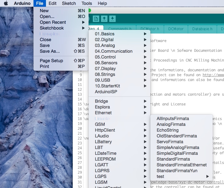

    Roi,
    as you can see in the following image, there are several kind of Firmata "versions" you can upload to your Arduino board. Depending on the one you choose you can use the same protocol to manage analog signals instead of PWM and so on.
    here are two links related to the protocol: image
    Firmata Messages : Outgoing | Devartia
    Firmata Messages : Incoming | Devartia
    I suggest to try to upload the StandardFirmata version, sure excluding the Ethernet, Yun and Analog, Servo firmata as they are specific for features that you don't need. Then try it the communication works fine with the PC.
    Enrico
