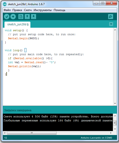

Dear colleges,
Thanks a lot. There are very useful material here. But I have some problems:
this is my code:
void setup() {
  // put your setup code here, to run once:
  Serial.begin(9600);
void loop() {
  // put your main code here, to run repeatedly:
  if (Serial.available() >0){
  int val = Serial.read()- '0';
  Serial.println(val);
and this is result:
when I print in SerialPort: 1
SerialPort write:
1
-35
-38
when I print in SerialPort: 2
SerialPort write:
2
-35
-38
Why it's heppen?
The -35 and -38  are negative acknowledge and device control 2 respectively.
But I want print only my variable, like you in your code.

  • beacon_dave
    0 beacon_dave over 10 years ago in reply to spannerspencer
    Already answered at:
    Tutorial 06 for Arduino: Serial Communication and Processing
    Need to disable NL & CR in the Arduino IDE serial monitor.
    • Reject Answer
    0 e14 Contributor over 10 years ago in reply to beacon_dave
    Thank you. it helped me a lot.
