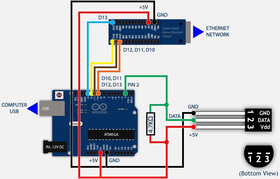

How do I connect my Arduino Uno to internet using ENC28J60 ethernet shield?
e14 Contributor
I'm sorry for my bad english, and this is my first time here...
I've been trying to connect my arduino to internet using ENC28J60 ethernet shield, but it is just not getting through...
even if it connect, the data I want to send to a database cannot be sent..
please help me....
as for the code, I've come here to ask that... thank you..

    Please provide the diagram of how you currently have it connected and also the sketch you are using. You can paste the sketch right into the post, and the picture of the wiring can also be simply embedded into the post as well using the "insert image" icon just above the edit window. The enc28j60 is very easy to use but we need to see what your doing show we can tell you where your going wrong
    • Reject Answer
    0 e14 Contributor over 10 years ago in reply to Robert Peter Oakes
    I've added the pic. but as for the code, I don't really know...

    I think that the standard arduino library for ethernet shield are for the W5100 ic, for the ENC28J60 you can find other library, ethercard:
    https://github.com/jcw/ethercard
    Hope that helps

    The ENC Board you show does not apear to be a standard board. Based on the print you show on the bottom, it is a complete controller on its own ?, can you provide a link as to where you got it and a datasheet ?
  • Robert Peter Oakes
    0 Robert Peter Oakes over 10 years ago in reply to Robert Peter Oakes
    I found a link to it
    there is mention in this article http://www.tweaking4all.com/hardware/arduino/arduino-enc28j60-ethernet/      that the ethercard library uses pin 8 of the arduino instead of pin 10
    Have a read of the article and try its example. let us know if it works
    I got it from that article... but it seems that it couldn't work, I don't know why.. -_-
