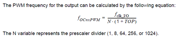

    Bingo. Output frequency is given by this formula in the datasheet:
    f_clk_IO = 16 MHz
    N = 8 as you already figured out is the prescaler
    TOP is given by value in ICR1 in mode 14 (notice how value in TOP is increased by 1 for reason discussed above, so 39999 is increased to round 40000)
    This gives:
    f_OCnxPWM = 16E+6 / (8*(1+39999)) = 50 Hz
