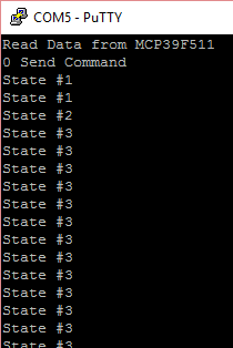

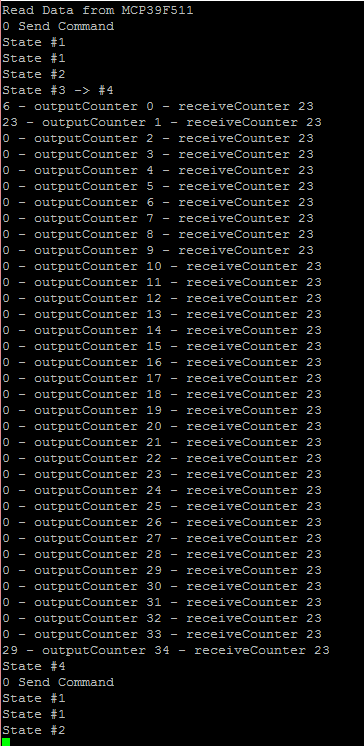

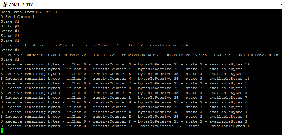

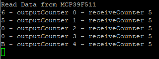

The device returns 35 bytes but the MSP430 device only sees 16 of them.
When I turn off debug (debug = 0) but still output the states (except for state 3) the output looks a lot more acceptable but only runs once. It starts to receive the second set of data but stops at state 3.
Once debugStateThree is enabled things really stop working. If left this ends up being an infinite loop.
The data format from the MCP39F511 is a bit odd in that the baud rate is set to 115200 yet the data cannot be sent continuously at that clock speed without breaks, notice the time delay in the send portion of the code, delayMicroseconds(timeSlot); without this the MCP39F511 returns a NACK. Also the returned data is returned in blocks of two bytes.

    The answer I found in my last post. Thanks to Robert Peter Oakes suggestion of trying less than 16 bytes I was able to see that the receiveCounter value a bit clearer. If you look in the last picture in…
    0 shabaz over 9 years ago
    Hi Kas,
    I've not used the serial library, but I'm wondering if 16 bytes is a limit on some or all MSPs. There is the HardwareSerial library here, and it states some 16 byte limit.
    One solution could be to limit the transmission to separated 16 byte bursts, i.e. give the receiving program some time to read the content out of the buffer and then loop.

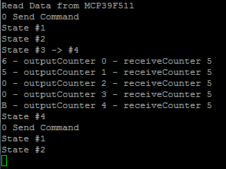

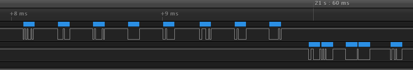

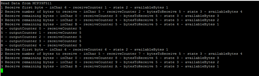

    I have now reduced the amount of data requested to see if there is anyway the buffer is the issue. The code was changed to request TWO bytes of data. For this there are a total of FIVE bytes returned (header, number of bytes, data[2] and checksum). This would allow for a lot of space in the buffer and should prevent any issues.
    0xA5 - 0x40 is the data sent to the MCP39F511
    0x06 - 0x0B is the data returned to the MSP430
    Data packet sequence that is sent and returned to and from the MCP39F511
    As can be seen from the above image this did not resolve the issue (debugState = 1). The program still hangs after receiving the first data received from the MCP39F511.
    All debugs have been disabled.
    With debug = 1 the program still stops after the first iteration, it starts teh second but teh program does not continue.
