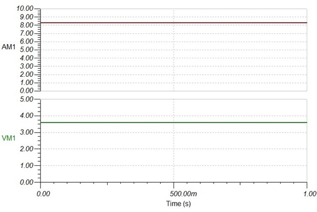

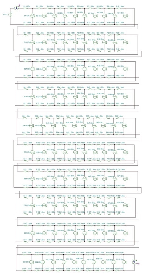

    Here's a simple simulation to illustrate the voltage drop problem. [Cut and paste was my friend here!] Each LED is crudely modelled by an 83mA current sink. It's a bit approximate but it gives an idea of how things pan out.
    This is 100 devices running at 83mA (total current 8.3A), which is 0.7m of strip if you have a 7mm pitch. I've assumed a track width here of 2mm. This is exaggerated just for illustration, I'm not suggesting you use that as your track width. The resistance comes from 7mm length divided by cross sectional area of 35u thickness times 2mm width times conductivity of copper, which gives 1.68mOhms. As you can see, the last device gets just 3.6V when all the devices are full on and close to 5V when all the preceding ones are off, so it's going to be bouncing up and down like a yo-yo. Obviously the situation gets much better as you widen the tracks.
    The other factor with pcb tracks and the one a layout person would normally focus on is the temperature rise from the heating effect of the current. For 11A and a 20C temperature rise you need about 6mm width for an outside track on FR4 - you might find it's very different for a flexible board (I don't know - it could be better or worse), so you need to find that out.
