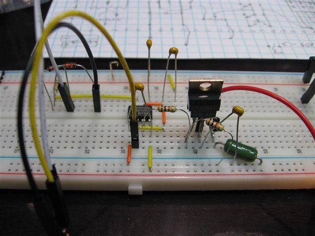

How do you use a mini breadboard? I haven't found that many videos that really explain how to use one. I want to learn as much as I can about Arduino so any advice would be great thanks.

    Hi Isaac,
    The bread board is just a way of making connections to components and fabricating a circuit. Here is a picture of one I made on a regular sized bread board.
    The mini bread board does the same thing only on a smaller scale. If you use your ohm meter and some wires you will find that the 5 vertically aligned holes are all connected together. This allows you to connect multiple wires to each node. You will have to do some experimenting and then ask more questions as they arise.
