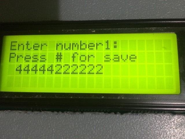

I can only store 1 number. and use * as back space , I am a newbie I am trying to ask the users for two numbers store it as new num for the first the first input phone number and store as newnum2 the second phone number user entered but I am confused. It doesn't give me the right output.
I edited it and put comment for the wrong code cause if I added It it wouldnt display and store even one phone number but this code that i posted can show the input and store number Thank you for help image

    Hello Please can you give us some more information on hardware, what kind of display you are using ?

    I am using 20 x 4 LCD and 3x 4 keypad can only save one number it

    Simplest way (although horrible inefficient) would by to define some variable for differentiating between entering number 1 and 2, like so:
    char entering_number_2 = 0;
    void loop()
         int key = keypad.getKey();
         if(!entering_number_2)
              // code for entering number 1
              entering_number_2 = 1;
         else
              // code for entering number 2
  • aikachiq

    Just copy-paste your two chunks of code to the above if-else statement (code for entering number 1 to the if statement and code for entering number 2 to the else statement).
