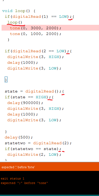

I'm a noobie in arduino stuff but..  why IDE does this? even if I put the ";" before tone it prints the same error

    one bracket is missing too

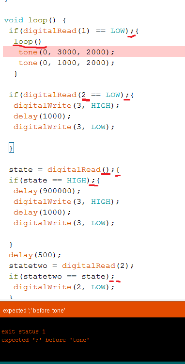

    There are a number of issues you need to take a look at.

    Well spotted image

    Well spotted image
