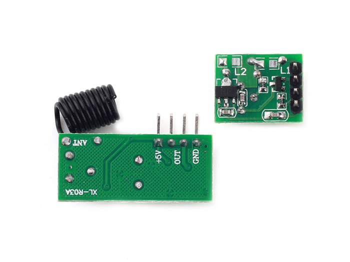

    I have theses
    https://www.seeedstudio.com/433Mhz-RF-link-kit-p-127.html
  • redgreenblue
    0 redgreenblue over 9 years ago in reply to neilk
    Hi Neil,
    I found the problem.
    The remote I've used is not decode by the RF module.
    I've use my Power/On/Off remote for ceiling fan and it work right away.

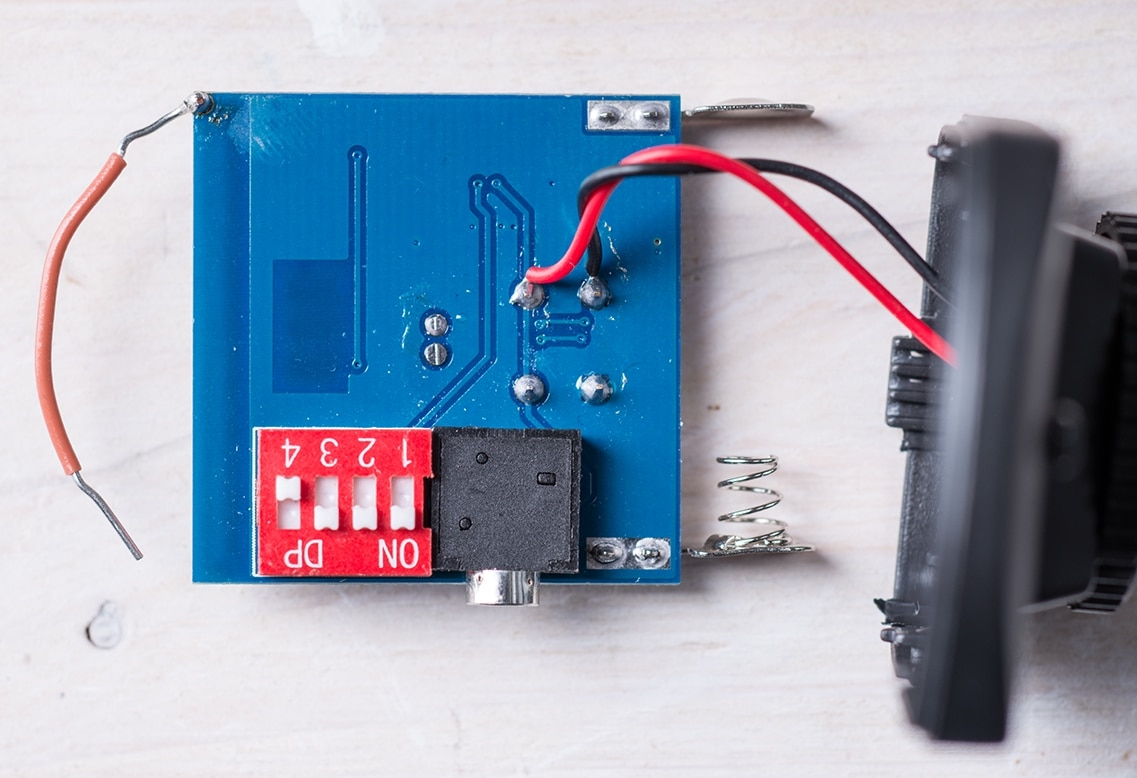

    Stil what I need to decode is a 433mhz remote to trigger studio flash.
    They are cheap trigger from china and they have a 433mhz unit on them.
    I just figure out that becuz they have this unit, they should be detected by the RF module on arduino.
    Here a picture.
    Do you think there is a way to decode them ?
    It's for personnaly use only.
  • Robert Peter Oakes
    0 Robert Peter Oakes over 9 years ago in reply to neilk
    that looks like it came from a sonoff image

    I've not seen the inside of one, but don't they usually have 4 buttons?

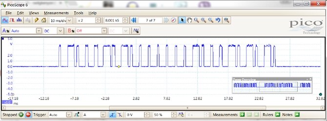

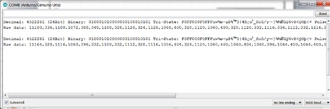

    Hi redgreenblue I've just treated myself to a picoscope USB oscilloscope, which has allowed me to get closer to the 433MHz transmission protocols.
    Here is a capture of a 24bit transmission from one of my remote controls:
    If we assume that the narrow positive going pulses are "markers", the wide positive going pulses are "1"s and the wide low spaces are "0"s, then we can count 24 bits in the pattern.
    Reading from left to right, beginning with a marker, we can interpret the pattern as follows:  010001010000000100010101, which matches the output from the Arduino sketch ReceiveDemo_Advanced, from the RCSwitch library, shown below:
    If you have access to some kind of storage/USB scope, maybe you can do the same?
    Neil

    0 neilk over 9 years ago in reply to redgreenblue
    Your RTL-SDR device clearly has the potential to be used in a variety of extremely sophisticated ways, most of which appear to be way above my pay-grade!! i followed through on some of the links and they look very complicated.
    The picoscope is a USB version of the good old electronics workhorse, the storage oscilloscope. I have the 2204A, which is the cheapest model available.
    In order to achieve the capture shown in my previous post, all I did was connect a probe from the picoscope to the 433Mhz receiver output (ie the one connected to pin 2 of the Arduino), set the picoscope trigger to auto and then hold down the remote button, adjusting the horizontal timebase until I could see 2 or three groups of pulses in the display. As you can probably see, the timebase setting is 10mS/div. This gives a good starting point.
    I then set the trigger to single and pressed the remote button again. This gave me a one-shot capture of the receiver output, which captured 1 complete data block and 2 partial data blocks. I could then focus on the complete data block and expand it for detailed examination. You may have to do this several times to get a good display and maybe readjust the timebase
    As to interpreting the data block, obviously, knowing what result I wanted to achieve (from the Arduino sketch) made things easier. I'm also lucky in that the protocols being used in the remotes I am working with are quite straightforward and supported by the RC-switch library.
    I am a retired software engineer, but I started my professional career in medical electronics, moving to software via digital electronics.
    Best wishes
    Neil
