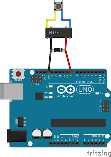

  • talongrayson
    0 talongrayson over 8 years ago in reply to jlangbridge
    I think I'm confused... like this?
  • jlangbridge
    0 jlangbridge over 8 years ago in reply to talongrayson
    The other way around, the "illogical" way. The way you put it, if you power up pin 8, it will go through the diode, and to ground. If you put the diode the other way around, then the diode will block the flow, and basically do nothing. The problem happens when you shut down the electromagnetic field. EM fields don't like change, and will fight to keep things the way they are. If you power down the relay coil, it sometimes creates an inverse, essentially putting a + on the ground pin, and a - on pin 8, where there used to be a +. As you can imagine, even if it is extremely brief, it can cause damage to the board. To counter this, we use a diode. If the current is in the "normal" position, ie you are powering the coil, then it doesn't do anything. If you shut down the coil and the coil fights back, then it will short out the difference, protecting your Arduino. I'd add a few sketches, but I can't where I am right now...
    • Reject Answer
  • talongrayson
    Yep, that's "illogical". The thing is, I had it the other way around in the first place, thinking that's what you meant. Then the more I analysed the circuit and tried to understand it, the more it seemed like it should be the other way around. Not sure whether that was just newbie confusion or what, but hey, if it's correct then who am I to argue? image
    For completeness I've added the latest version of the diagram. Thank you once again for all your help. I'll let you know the results as soon as I have something to share.
  • jc2048
    0 jc2048 over 8 years ago in reply to jlangbridge
    "When the coil is powered, the diode is useless, but when the coil is powered down, any inverse energy caused by the magnetic field breakdown gets shorted out."
    I suspect that you'll find, in this case, the diode is always useless. The internal anti-static protection diode for the IO pin (it's in parallel with your external one) will have a lower Vf and will dissipate the coil's energy.
    • Reject Answer

  • jc2048
    No. I said I suspect. I can't know for sure how Atmel have implemented the anti-static protection, but the most common way is to utilise metal-barrier diodes that arise naturally as part of the process and don't cost the manufacturer anything (they're Schottky diodes and the forward voltage would be something like 0.2V or 0.3V at the relay current).
    It's not good design practice to use the internal diodes like this, which I think is why the manufacturers are a bit coy about giving specs on them.
    In practice, for a personal project, the microcontroller would manage. With a 500ohm coil, the max current is only 10mA and with such a low repetition rate the dissipation is next to nothing.
    The biggest disadvantage is a side effect: the slow release of the relay. The 0.3V means that the initial dissipation is low (10mA x 0.3 = 3mW) and the current through the coil will fall slowly. So the release of the contact, when it comes, will be slow and if it's switching a high current there may be problems with the contacts after you've done it a few times.
    • Reject Answer
  • jc2048
    I've just looked at the protection on an Arduino pin and it turns out I am wrong.
    Here's pin '8' set to be an input and driven with a sine wave that goes outside the supply range (with a series resistor to limit the current). Ground is where the '2' marker is, so we are looking at negative voltages. The yellow trace is the sine wave, the blue trace is the voltage that the protection network in the chip is clamping it to. It's a much larger voltage than I would have thought (about -780mV at the centre, at a current of around 8.5mA), so I'm quite wrong about how they are doing it.
    Here it is with an external 1N4004 added, and the external diode is having an effect - its forward voltage is coming in at less than the protection network.
    Ok, that's for an input. But what if you don't turn it back to an input when you don't want the coil to be powered but just set the output to be low? In that case we get this
    because the MOSFET channel is bidirectional and will clamp the input to ground even when it goes negative. I've now raised the current at the centre to about 10mA and you can see that the voltage is now about -180mV. That gives a dynamic resistance for the MOSFET of about 18 ohms, which is about right for a processor IO pin.
    • Reject Answer
  • talongrayson
    0 talongrayson over 8 years ago in reply to jc2048
    Not going to lie, I mostly don't understand your post, though I do find it intriguing and would like to understand it. But for now, is the outcome that I need the diode there and my current setup is all good?
    As discussed before, I am using pin 8 as an output and using digitalWrite(8, LOW) when I don't want the coil to be powered.
