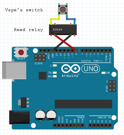

    0 talongrayson over 8 years ago
    Progress so far:
    I have soldered wires to 2 pins of the vape device (essentially the blue and yellow wires in the below diagram). I have run those wires to a breadboard with a switch, and that switch can now act as the FIRE switch on the device itself.
    I have ordered a reed relay and intend to wire it as below. I will probably stick a 2-pin JST between the relay and the vape for convenience.
    If this goes to plan, all that remains is the actual costume itself. And of course, if it works, jlangbridge answer will be marked as correct.
    • Reject Answer
  • jlangbridge
    0 jlangbridge over 8 years ago in reply to talongrayson
    Hi there! Sorry, the weekend was a little more hectic than expected. Looks good, but I am a little worried about one thing. I'm not too sure the Arduino can supply enough current to be able to activate the reed switch. I don't have any, so I can't check. If it doesn't work, there is something else you can try; instead of connecting one of the pins to GND, connect it to the 5V supply. You will need to change the code slightly; if the "output" is high, then no current will flow. If the "output" is low, then current will flow from the 5V rail to the pin (this is known as active low). The problem will all of this is that the MCU can only provide (and sink) a certain amount of current before damage can occur. Another thing to take into account is the use of a snubber diode; when electromagnetic fields collapse, they can sometimes generate a spike of current. Some reed relays actually have one built in.
    That being said, everything looks good! You have effectively put a switch in parallel, so you should be good to go as soon as you confirm the timing is good, but that is only a software tweak.

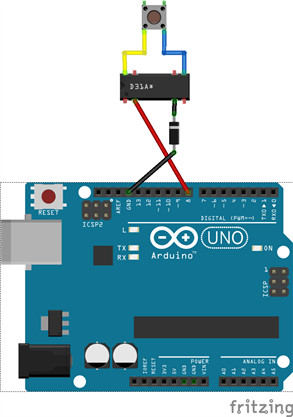

  • talongrayson
    0 talongrayson over 8 years ago in reply to jlangbridge
    No problem at all about the delay - I've enjoyed looking into this stuff!
    Thanks for the active low tip. I'll bear that in mind if things don't work properly. And as for a snubber, I have some 1N4004 rectifier diodes here which I can use.  If I've learned well enough, the below diagram should be correct.
    Just gotta wait for the relay to arrive and I can see if it works! image
  • jlangbridge
    Not quite! The diode will be between the relay's coil pins. Have a look at the Wikipedia page, the first schematic.
    https://en.wikipedia.org/wiki/Flyback_diode
    When the coil is powered, the diode is useless, but when the coil is powered down, any inverse energy caused by the magnetic field breakdown gets shorted out.
