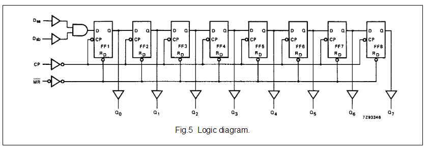

I am having some troubles getting the readouts from the shift register.
The 74HC_HCT164 controls a EADCD040YA2 (or alike) two digit 7 segment display.
Is there any way that I could reliably read the Serial input data from the shift register.
I have got a pin-out of the shift register to the display, so that shouldn't be any problem.
What might be useful to know, is that the shift register circuit is not only used for the display, but also for some of the LED's.
The data is shifted into the shift register, then the first common anode is turned on by the microprocessor, then the shiftregister latches, shift register clears, second diigit data get's shifted in, second common anode is turned on, shift register latches and shift register clears.
I don't know if there is happening anything between the two digit 'shift's' and what's the clock cycle of the whole circuit. I don't have access to an ocsilloscope, well, I do if you call my Arduino one.
I am using an Arduino to read out the code (using the following sketch: https://pastebin.com/8fWA6qUP)
I would appriciate it very much if anyone could help me out with this problem!
So to be clear: this is NOT about using a shift register the normal way, but to basically hack shift register and read what's being send to it!
Tim

    tim687 The 74HCT164 is a serial to parallel converter. Basically you set the state you want on that particular output using the two inputs and then raise the clock. You need to do this 8 times to replace…
    You need to do this 8 times to replace/set all 8 outputs
    You need to read the value of the two data lines, and note them when the clock goes high.
    You'll also need to check if the MR line is able to change, since it will reset the outputs.
    Most 7 segment displays only need 4 bits, which means they could easily use the other 4 outputs for something else.

    So you'd say I'd have to read out input A and B from the shift register and perform a (bit wise) AND operation onto them to get the input data?
    The problem I'm having is that the two (serial coded) digits sometimes get swapped around.
    The display definitely is a 8 bit display. It has got a total of 10 pins, 2 common anodes and 8 data pins.
    The problem is however, that I will be using this in an IoT project, so I'm starting to get very tight with the available pins. I've freed up two pins using, how hilarious image, a shift register.
    That means that I only have a pin for the serial input A and the clock. I could free up more pins by using a shift in register, but I think that it would make the whole project to complex than it needs to be.
    Thanks for your diagram though! I haven't searched for one to be honest image
    Thanks again!
    Tim

    0 mcb1 over 9 years ago in reply to tim687
    Besided checking both inputs, any other options
    Not really.
    If this is the same circuit as you gave in the other link, then there is a single Input data line, and a clock.
    There must be a second select line for the digits.
    A Parallel to Serial will simply give you back the input data, and you still need to read it.
    Googling Binary to BCD gives lots of hits but nothing really sticks out.

    The schematic isn't fully complete, but for a parallel to serial chip, how do I deal with the two digits being send? Do I need to connect the clock signals from the original register to the parallel to serial one?
    Yes and there is the issue.
    You actually don't really save anything in terms of pin numbers.

  • michaelkellett
    0 michaelkellett over 9 years ago in reply to tim687
    I don't think you'll ever pull this off without a scope or  a logic analyzer.
    A scope may well be outside your budget but you may be able to afford a cheap logic analyzer.
    hobby components usb 8ch 24mhz 8 channel logic analyser. compatible with saleae software.
    This one is typical of the cheapest - it's limited to 24MHz which might be a problem (the clock to the shift register might be faster than this). I haven't used it so it may be rubbish - look for reviews.
    To sort out how the display drive is working you need  to monitor the clock, data and anode signals - so you need at least 4 channels - once you know the protocol you may be able to decode what is sent with less.
    If the circuit is the same as the link the two data inputs are paralleled, so 3 channels, but yes otherwise I agree a logic probe or scope is required.
