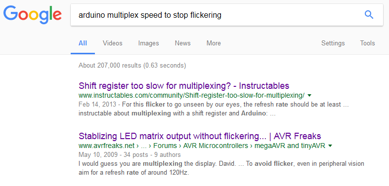

    mcb1 over 9 years ago +2 suggested
    Seems to be a wide variance according to this.
